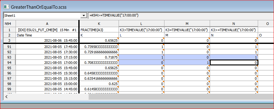

[2021-08-08 18:18:54]
Sawtooth - Posts: 4359
In a spreadsheet study, when comparing a FRACTIME to a TIMEVALUE, the >= operator ignores the =
However,
When comparing the same FRACTIME to the same TIMEVALUE, the > operator is accurate.
When comparing the same FRACTIME to the same TIMEVALUE, the = operator is accurate.
Formula Details of the inaccurate >= operator:
[ >= ] K94>=TIMEVALUE("17:00:00") = 0 (number, integer)
  [ K94 ] K94 = 0.7083333333333333 (number, double)
  [ TIMEVALUE ] TIMEVALUE("17:00:00") = 0.7083333333333334 (number, double)
    [ "17:00:00" ] "17:00:00" = "17:00:00" (text)
K94 contains this formula:
=MROUND(FRACTIME(A94),1/86400)
M94 = 1
N94 should also be 1.
See pic for reference.
See .scss for more.
Please advise.
attachmentGreaterThanOrEqualTo.scss - Attached On 2021-08-08 18:17:13 UTC - Size: 1.19 MB - 498 views
imageGreaterThanOrEqualTo.PNG / V - Attached On 2021-08-08 18:17:25 UTC - Size: 22.39 KB - 429 views
[2021-08-09 06:31:23]
There probably is just is a very small a difference related to floating-point error, resulting in this. So in effect there is no problem and you need to accommodate for that difference.
We will have a look though.

[2021-08-09 16:43:27]
If that were the case, then why does the = operator by itself return TRUE?:
[ = ] K67=TIMEVALUE("17:00:00") = 1 (number, integer)
  [ K67 ] K67 = 0.7083333333333333 (number, double)
[2021-08-09 18:17:25]
Jeffrey - Posts: 2443
The equal operator (=) by itself is designed to allow some wiggle room if the numbers are slightly off. But the greater or equal operator (>=) enforces that if the left value is even the tiniest bit less than the right, then the operator returns FALSE. That's what's happening in this case.
Here are a few alternative formulas you could consider:
=K94>=TIMEVALUE("16:59:59.999")
=K94>=TIMEVALUE("17:00:00")-1/86400000
=OR(K94>=TIMEVALUE("17:00:00"), ISSAMETIMETOMILLISECOND(K94, TIMEVALUE("17:00:00")))
More generally, only the equal (=) and not-equal (<>) operators have this extra provision to handle numbers that are slightly off. All of the other operators (<, <=, >=, >) are strict in their comparisons. This could potentially be changed if the minor impacts to performance and accuracy are considered worth it.
[2021-08-09 20:36:39]
Dealing with floating point imprecision is a continual problem, so this change would be welcomed.
