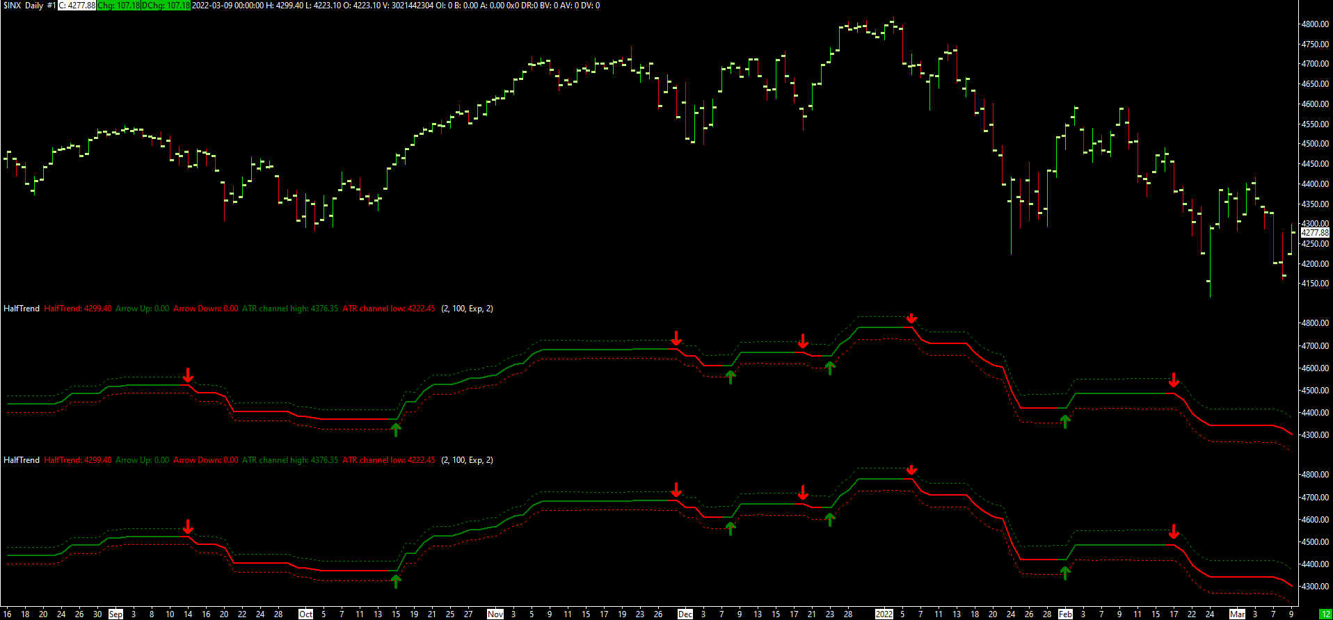

[2022-03-10 01:21:55]
SC Support Tom - Posts: 450
Hello, and sorry for the delay on this.
I am working from the code in Post #11, and I made a couple of slight modifications (in addition to changing some Subgraph, Array, and Input names).
* I added an Input for selecting the MA Type for the ATR, and I set the default to EMA (not SMA). That is because Pine Script uses the EMA for the ATR.
* When calculating the Deviation ("dev"), you forgot to divide by 2. I fixed that.
The one question that I have is, why do you include the following lines?
149 Array_up[sc.Index-1]=Array_up[sc.Index];
165 Array_down[sc.Index-1]=Array_down[sc.Index];
These do not appear to be warranted by the code in Post #1, and indeed they appear to make no difference whatsoever. Please see the attached image. In the Subgraph in Region 2, the I omitted the lines. In the Subgraph in Region 3, I included them. The two Subgraphs are identical.
image$INX Daily #1 2022-03-09 19_12_42.994.png / V - Attached On 2022-03-10 01:21:53 UTC - Size: 43.94 KB - 459 views
[2022-03-12 03:18:10]
This is done. The HalfTrend study will be available in the next release.
WRT Post #12, I have omitted the two lines referred to therein.
