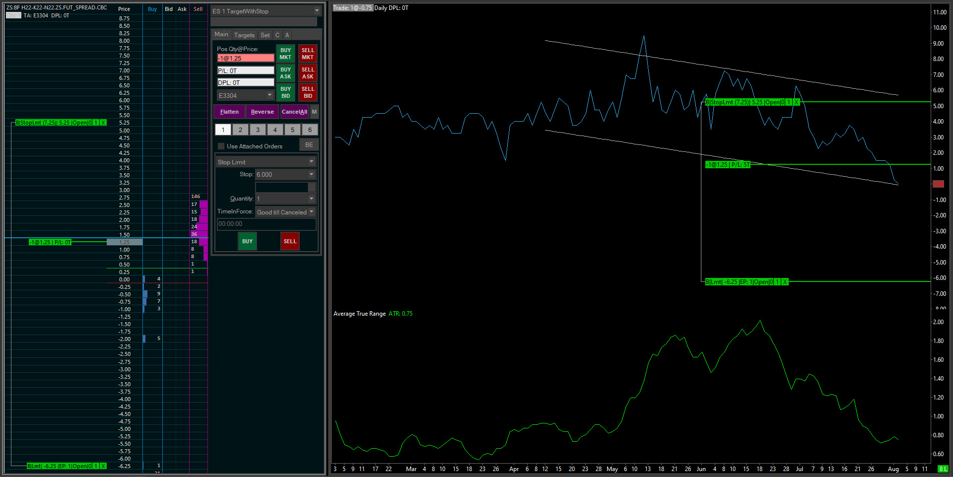

When this spread (see attached jpg) trades at a value of 0.00, the last price jumps to 1.75 and shows -9 ticks. The chart beside the DOM shows the correct values. Am I missing some setting on the DOM?

We do not know why the highlight is at 1.75, but the price point is definitely 0.00, as you can see the Bid and Ask depth data is split at the 0.00 level.
You will need to look through your studies and see if there is a Value Label that is displayed in the Right-Side Price Ladder or something else that might explain where that label is coming from.
[2021-08-02 17:25:00]
SpearChucker - Posts: 116
No studies on that DOM. The P/L: also shows -9 ticks, which is not correct. I'll keep looking. Not a big problem, although I don't want my stop triggered with an incorrect price. Thanks.

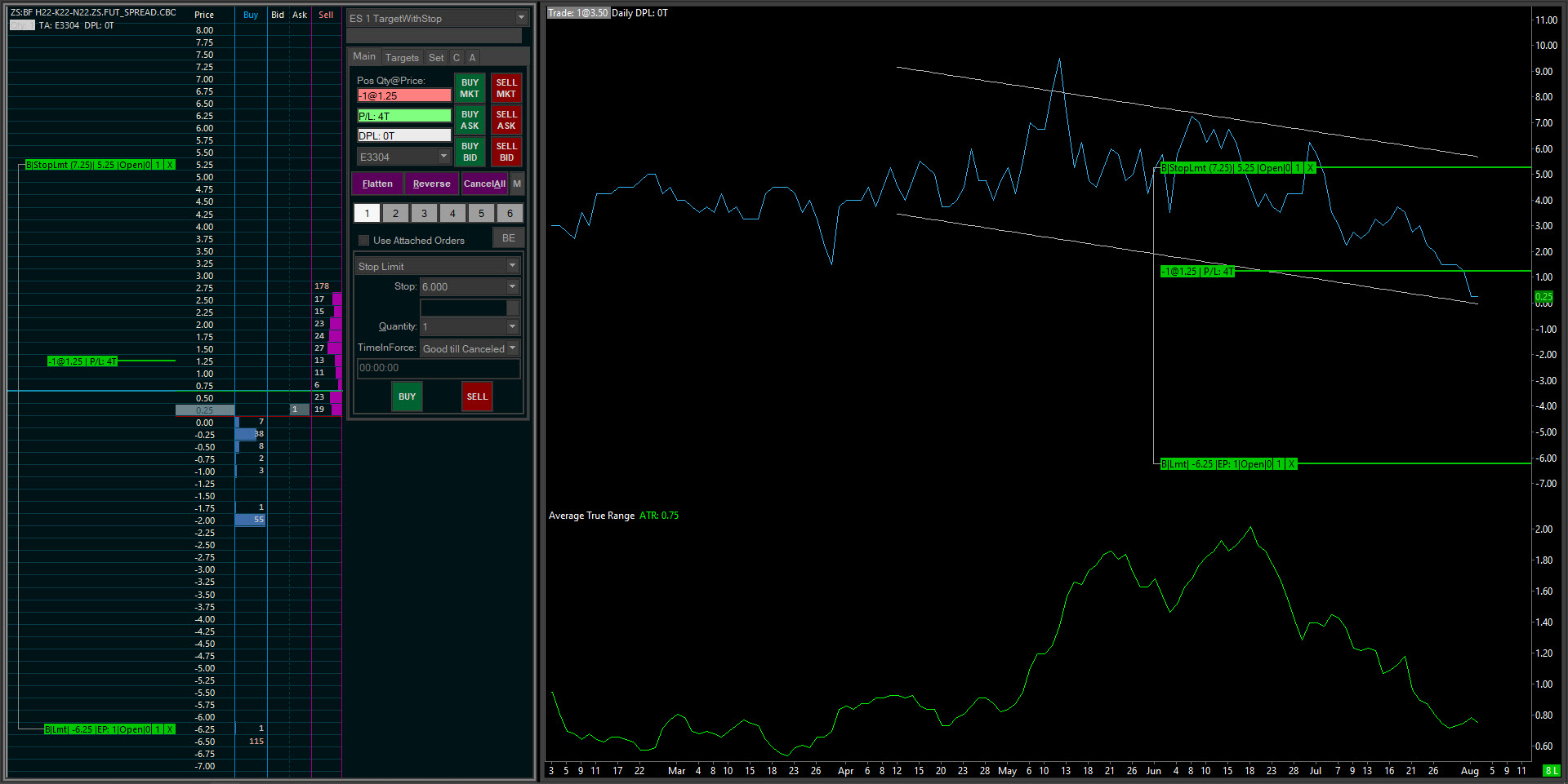

[2021-08-03 15:31:04]
Yes, it appears that way. And, only on the DOM. When we trade away from 0.00, they match again. In the attached jpg we traded at 0.25 and all is fine. I'm assuming since my tgt and stop are held on the exchange there's no chance of them being triggered by this issue.
