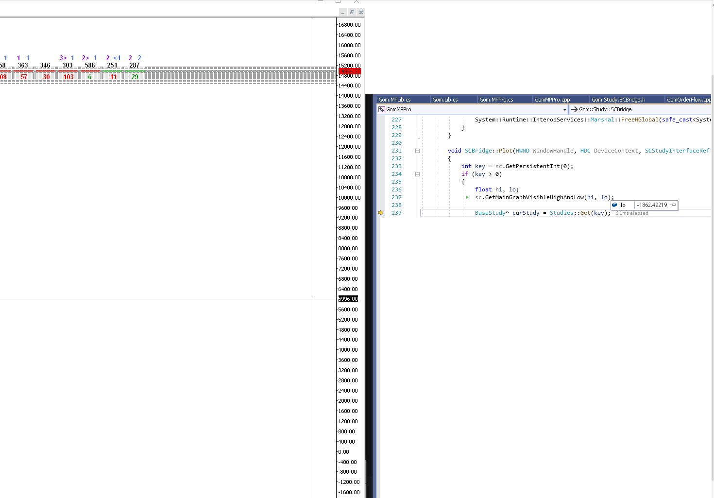

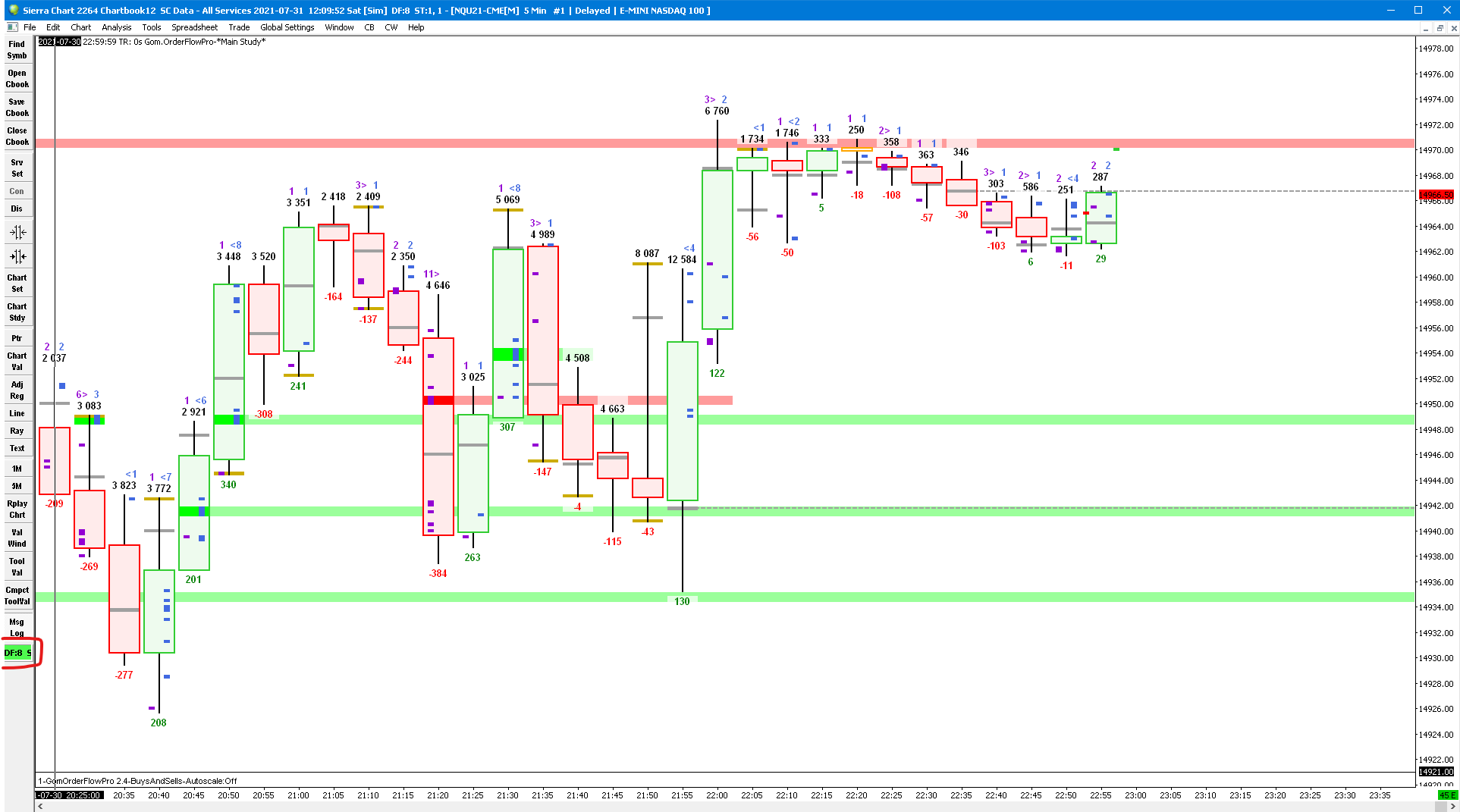

This is an old issue, that appeared quite some time ago.
If there is no data connection and we show on the chart more bars than the last existing bar (scrolling to the right), the GetMainGraphVisibleHighAndLow return false values (here a negative value)
However if we connect to a data source the issue goes away.
It used to work as expected but this bug appeared one day.
imagesierra1.png / V - Attached On 2021-07-31 10:15:48 UTC - Size: 39.16 KB - 386 views
imagesierra2.png / V - Attached On 2021-07-31 10:15:53 UTC - Size: 70.08 KB - 356 views

Sierra_Chart Engineering - Posts: 25390
We tried multiple times to reproduce this and could not. There is no obvious reason why it would occur.
[2021-11-06 22:22:05]
gomifromparis - Posts: 244
I'm very sorry for this, I should have posted a complete example with a study.
I tried to reproduce with a simple study like you did and couldn't.
After retracing in my own code, it had to do with sc.Bid and and sc.Ask equal to 0 when the feed is not connected, so my scaling functions scaled the chart starting at 0, and so the GetMainGraphVisibleHighAndLow got negative (because of the margins)
Again, very sorry you had to spend some time on this, and thanks for your continuing support efforts !
