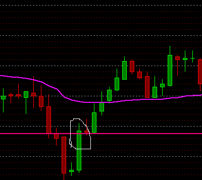

Could someone please help with this alert formula, I keep trying different things but i am stuck.
I have Horizontal lines (drawn Manually on my chart), i would like an alert for when:
1.) A Bearish Engulfing candle appears at Less than or Equal to 1% of where the horizontal line is (basically Within 1% of the Horizontal line), or when the bearish engulfing candle crosses and closes below the horizontal line
2.) A Bullish engulfing candle appears at Less than or Equal to 1% of where the horizontal line is (basically Within 1% of the Horizontal line), or when the Bullish engulfing candle crosses and closes above the horizontal line
Edit: I realize I have to use the Horizontal Line Indicator , rather than manual Horizontal line. Currently, I applied the Horizontal Line Indicator to my chart and set my alert there. My candle patter Bullish (ID6.sg1), Bearish (ID6, Sg2), so, this is what i have so far, is this correct or am i missing somthing:
=OR(ID6.SG1<=0.01, CROSSOVER(C, ID6.SG1), ID6.SG2<=0.01, CROSSOVER(C, ID6.SG2))
I attached a pic to give a visual Idea for the Bullish Engulfing Scenario (I hope it is clear enough)
I'd really appreciate any help i can get, Thank you

Neither of your example pics show engulfing candles.
It's not clear exactly what alerts you want.
- Are your alerts intrabar or only at close of bar?
- Must the Last price be within +/- 1% of the horizontal line?
- Can the Close be outside the +/- 1% band if it crossed the horizontal line?

With the picture i was trying to show more of what i meant in terms of the candle position in relation to the horizontal line (the pink line in the picture), so in the case where the candle opens within 1% of the horizontal line & when the candle close crosses above the horizontal line.
- I would like to be alerted only at the close of bar
- In relation to the bar, sorry, i should have originally specified that i would like for the Opening price of the said engulfing candle to be what is within within 1% of the horizontal line and not the close of the candle.
- Yes, the candle close can be outside +/-1% if it crosses the horizontal line
