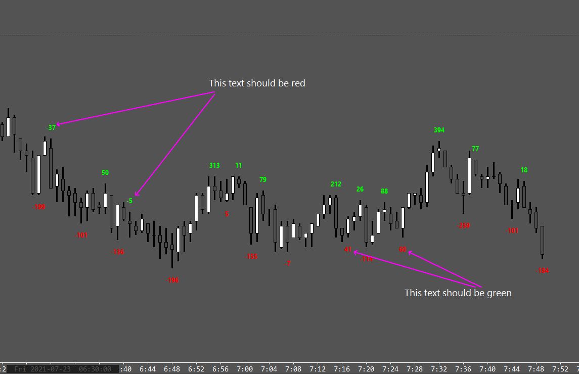

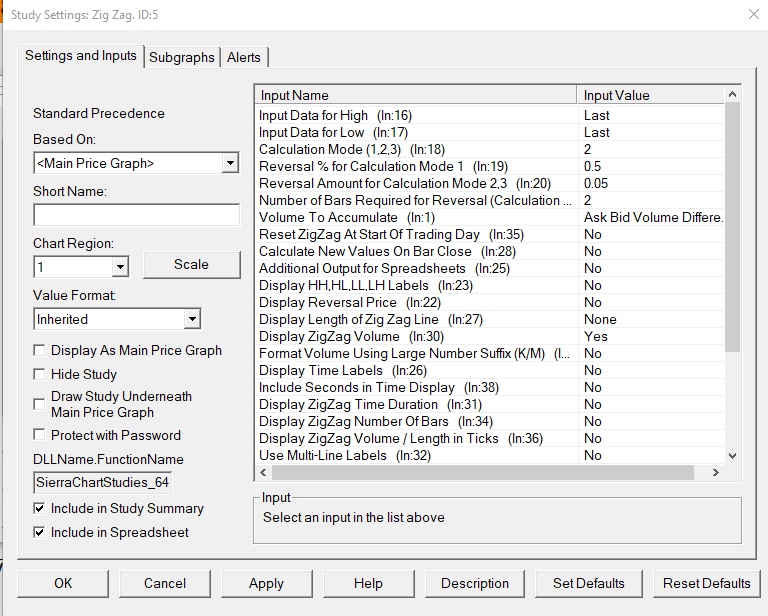

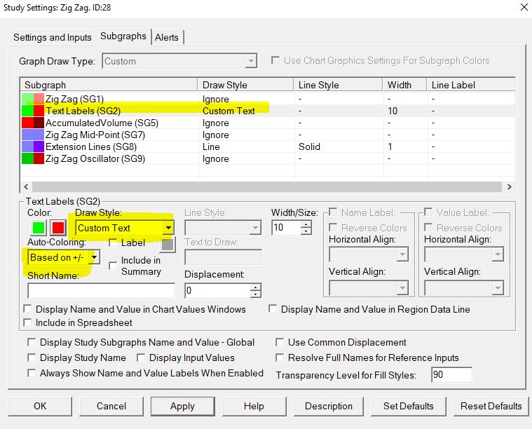

User483852 - Posts: 19
I am trying to plot Bid Ask Volume Difference using the Zig Zag Indicator as shown in the screenshot. I am trying to color the text based on + / - but the text on pivot lows gets colored red and pivot highs gets colored green. Please see attached screenshot. What would I need to do inorder to color the text based on positive or negative.
Thanks in advance.
imageScreenshot 1.JPG / V - Attached On 2021-07-23 12:55:22 UTC - Size: 105.44 KB - 351 views
imageScreenshot 2.JPG / V - Attached On 2021-07-23 12:55:26 UTC - Size: 61.95 KB - 413 views
[2021-07-23 18:04:38]
Sawtooth - Posts: 4361
It can't be done with the Zigzag study.
It can be done with two instances of the Spreadsheet Formula study:
1. Add the Spreadsheet Formula study:
- Set the Chart Region to 1.
- Set the Value Format to 1.
- Set 'Draw Zero Values' to No.
- Use a formula like this in the Formula field:
=IF(AND(ID1.SG9[-1]>0,ID1.SG9<0),ID1.SG5,0)
where ID1 is the ZZ study.
- Set the Draw Style to 'Value On High' and set the Width/Size to 10.
- Set the Auto-Coloring to 'Based on +/-'
2. Duplicate the above study.
- Reverse the operators in the formula in the Formula field:
=IF(AND(ID1.SG9[-1]<0,ID1.SG9>0),ID1.SG5,0)
- Set the Draw Style to 'Value On Low'
3. In the ZZ study, 'Display Zigzag Volume' needs to be No, or you can Hide the study.
Note: The formula only plots SG5 where SG9 changes polarity.
Date Time Of Last Edit: 2021-07-31 17:53:39

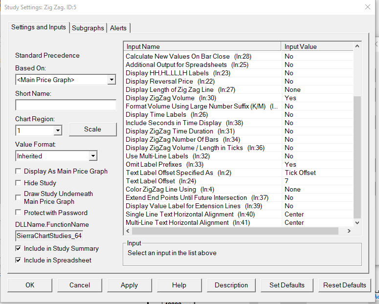

58LesPaul - Posts: 429

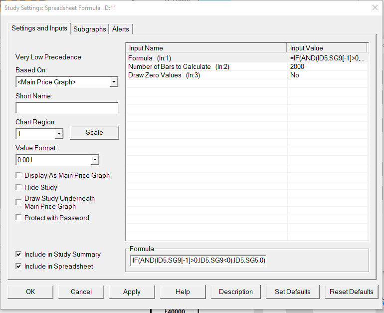

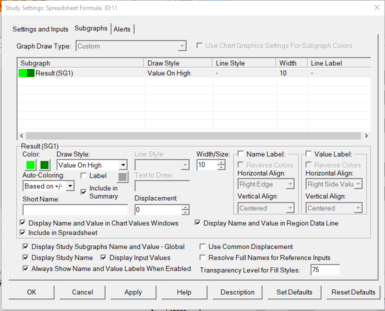

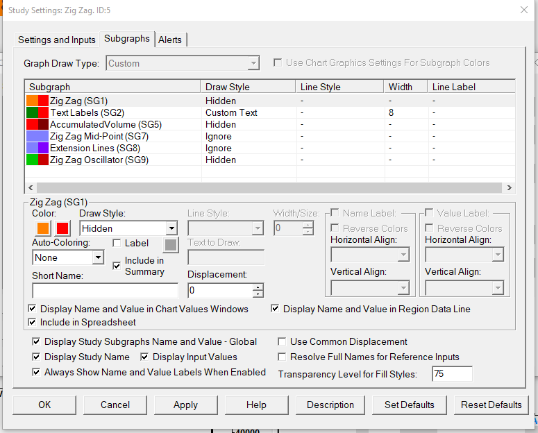

Can someone tell me what I'm doing wrong please?
imageZZ Study setting.png / V - Attached On 2021-07-31 17:15:17 UTC - Size: 65.66 KB - 377 views
imageZZ Setting2.png / V - Attached On 2021-07-31 17:15:26 UTC - Size: 66.84 KB - 303 views

[2021-07-31 17:17:23]
Spreadsheet Formula Study screenshots
imageSS Formula Subgraph.png / V - Attached On 2021-07-31 17:16:14 UTC - Size: 45.39 KB - 331 views
imageSS Formula window.png / V - Attached On 2021-07-31 17:16:21 UTC - Size: 36.21 KB - 400 views
[2021-07-31 18:16:45]
From post #3:
"3. In the ZZ study, 'Display Zigzag Volume' needs to be No, or you can Hide the study."
Also in the ZZ study:
Set 'Input Data for High' to High.
Set 'Input Data for Low' to Low.
Note: Except for the 'Ask Bid Volume Difference' at the legs you option, the ZZ study settings can be left at default if you Hide the study.
