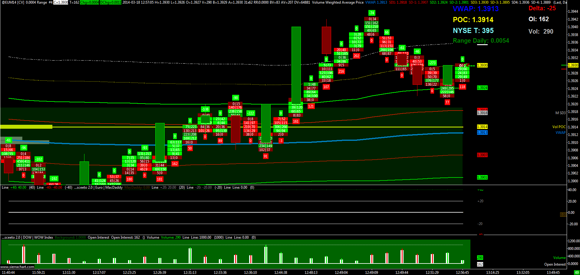

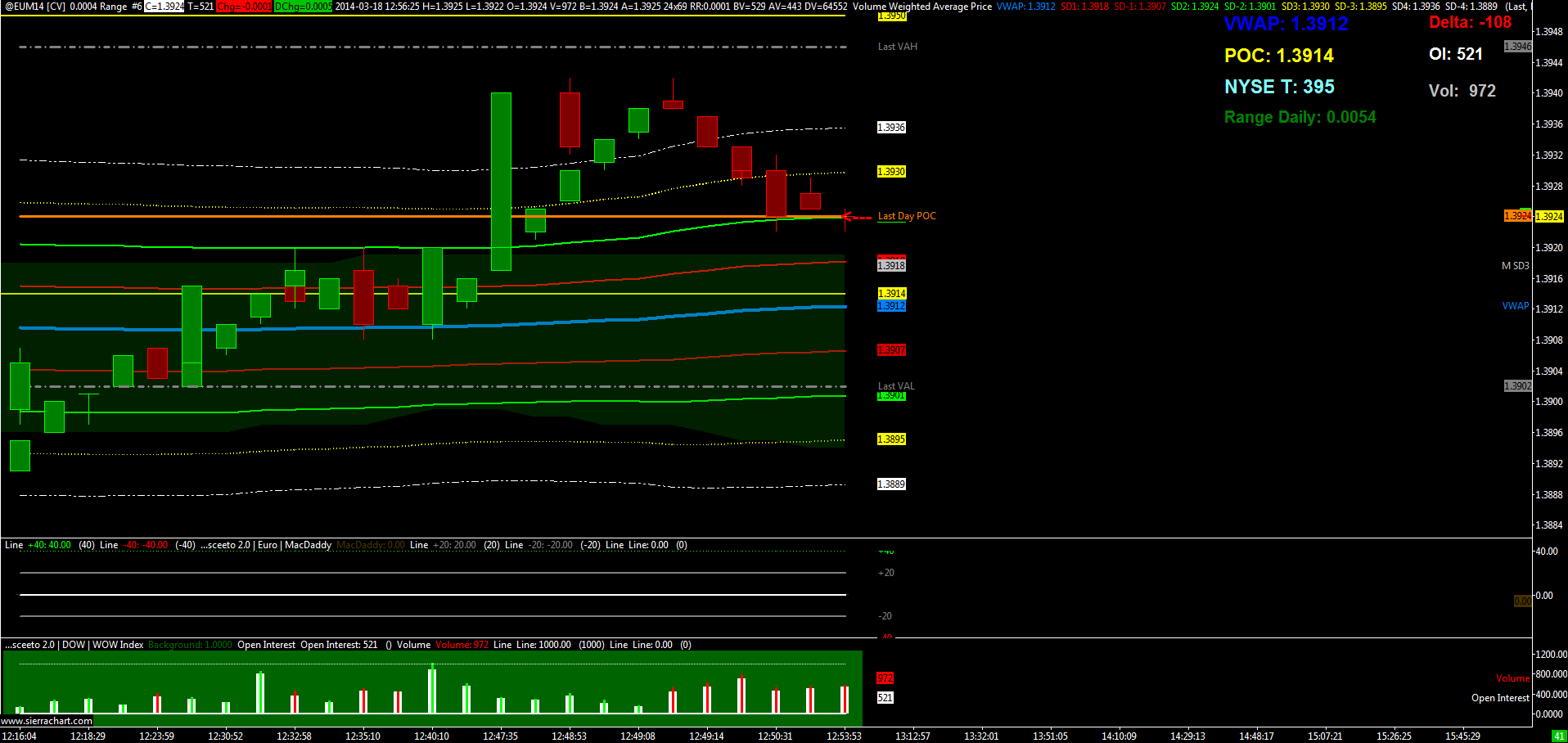

Strange problem where candles start forming in places at times in the middle of number bars, and on a candle chart (not obvious on the 2nd screenshot) previous candles (as in prior to the current ones) keep moving up/down..
Anything that might cause that?
image@EUM14 [CV] 0.0004 Range #4 41716.499.png / V - Attached On 2014-03-18 12:00:36 UTC - Size: 136.18 KB - 568 views
image@EUM14 [CV] 0.0004 Range #6 41716.498.png / V - Attached On 2014-03-18 12:00:44 UTC - Size: 93.04 KB - 506 views

It appears you have been provided a Chartbook from someone else.
We cannot help with that. The basic problem is you have been provided a sophisticated set up and then when there is a problem, you do not really understand what is going on. We do not either.
Our recommendation is to not use that Chartbook and set up your own Chartbooks that meets your requirements.
Another thing you can do is remove one study at a time through Analysis >> Studies to determine which one is causing these additional candlestick bars to appear. They must be coming from a study.
After that, close the Chartbook without saving and then reopen it to get the original one back. And then remove that particular study that is causing the problem.
