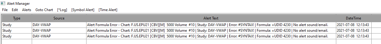

Everytime i start sierra chart I get a popup for alert formula error.
I have setup alerts for when price reaches certain levels which works fine but I am getting three lines showing up on the alert manager everyday. How do I stop this happening please?

You will have to find the alert(s) that is causing the error and fix it, or remove it. The information for where the alert is coming from is on the Alert Log. Refer to the following:

User313147 - Posts: 53
I have removed all alerts and still getting the error message

John - SC Support - Posts: 48222
Then there is still an alert somewhere. Show us an image of your Alert Log showing the error and we will help you determine where it is coming from.
see attached
The alerts on are on Chart #10 on the study in that chart that has a Short Name of DAY-VWAP. Find that study and remove the Alert from the Alert tab.
