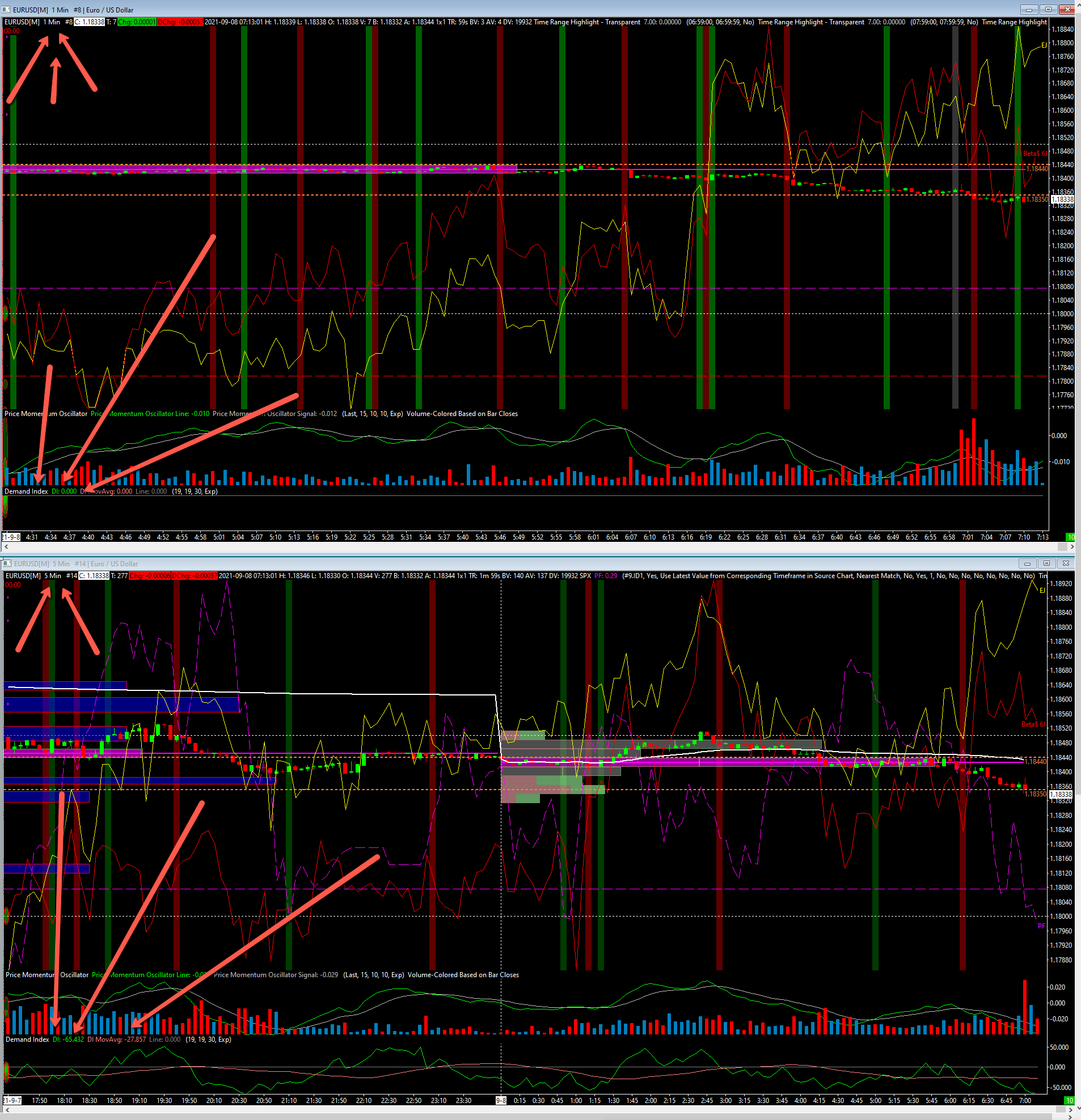

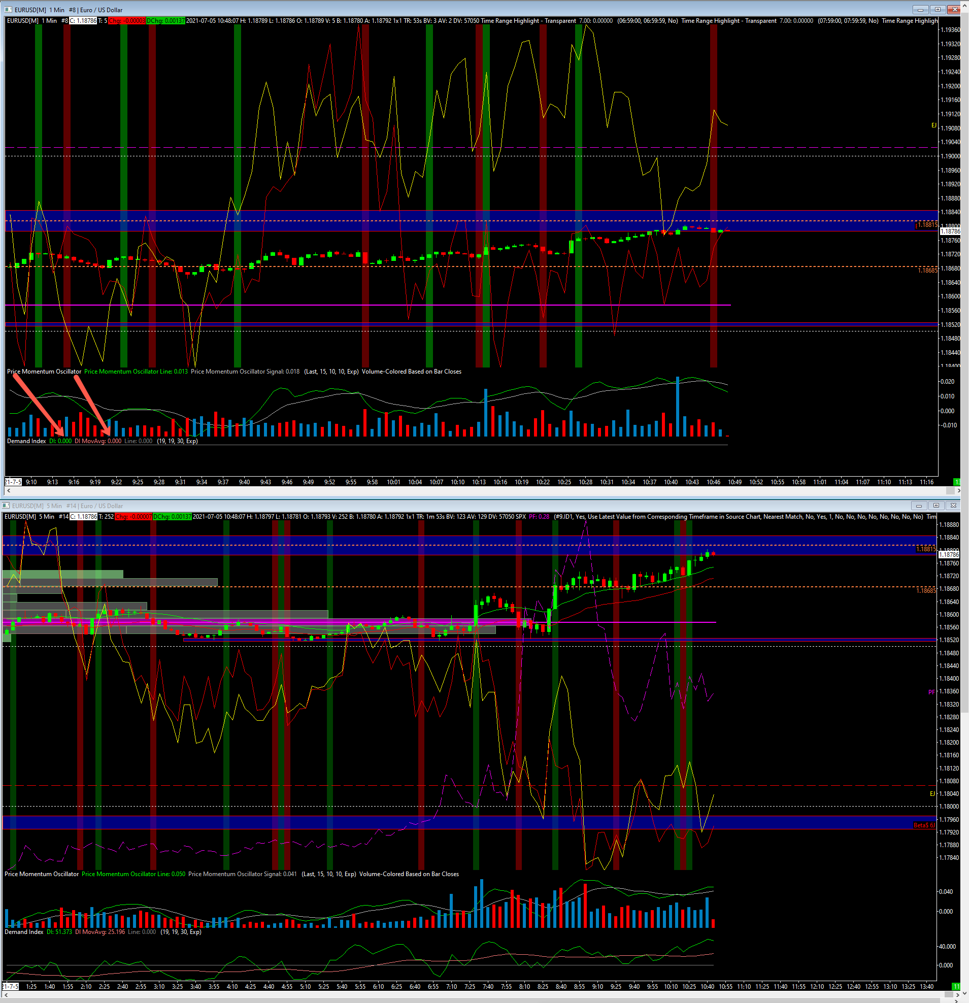

User93464 - Posts: 52
The Demand Index study has stopped working on my EURUSD 1 min chart. It displays correctly on the EURUSD 5 min chart. I also have the issue on the GBPUSD 1 min chart, but if I change the timeframe on the chart to 5 min and then change it back to 1 min timeframe, the study continues to display correctly. This fix does not seem to work on the EURUSD. I have tried upgrading the charts to the latest version, but this does not solve the issue
imageSierra Charts demand index EURUSD 2021-07-05_11-06-04.png / V - Attached On 2021-07-05 10:11:45 UTC - Size: 161.66 KB - 497 views
This issue seemed to have been resolved, but as of this morning the issue has returned. Demand Index will not display on the EURUSD in the 1min timeframe, but does so in the 5 min timeframe.
GBPUSD seems unaffected by the issue
Please reply ASAP
imageSC demand index issue 2021-09-08_07-14-40.png / V - Attached On 2021-09-08 06:16:23 UTC - Size: 241.93 KB - 405 views

SC Support Tom - Posts: 450
I believe that I have found the error.
In the code we see the following line.
if (Array_RangeMA[0] > SmallValue && Array_HL2C[sc.Index] > SmallValue)
Later we see the following lines.
else
Array_BuyPower[sc.Index] = 0.0f;
Array_SellPower[sc.Index] = 0.0f;
Whenever H[0] and L[0] are equal, Array_RangeMA[0] = 0, thus forcing the Buy Power and Sell Power Arrays to be zero for all chart bars. It is not that the Subgraphs are not being displayed; they are. I verified this by changing the colors. It is just that their values are zero. I have recommended a fix to Sierra Chart Engineering, which they will review.
