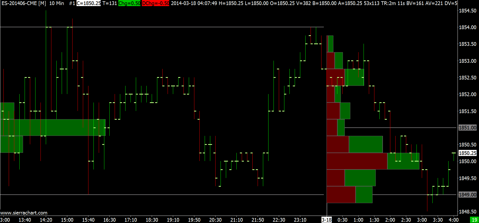

Here is an example of the Value Area extended until the End of Period:
http://www.sierrachart.com/image.php?l=13951300747.png
You should see something like this. If not, post an image of what you see, following these steps:
https://www.sierrachart.com/index.php?l=PostingInformation.php#Image
