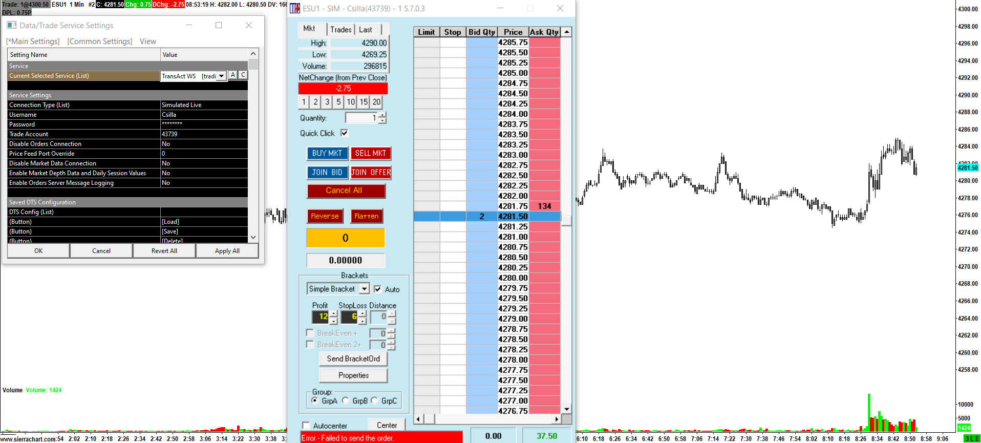

| User184555 - Posts: 6 |
Please see the image I saved now. http://www.sierrachart.com/image.php?Image=1625061200831.png I checked the Data/Trade Service settings and it is exactly the same as it is on my old laptop now, the only thing I added was the connection type which was empty when the trade did not show on the chart. Now I added the same option "Simulated Live" like on my old laptop and you can see what happened, now I can not even place a trade. I am even more confused now. Any other idea? Which connection type should I use? With this connection type I can place trades on my old laptop, so I do not understand why is it happening on my new laptop? Thank you for your help again, Csilla |
| [2021-06-30 14:23:01] |
| John - SC Support - Posts: 47980 |
Are you trying to place the trade from Sierra Chart or from the TransAct DOM? If you are doing it from the TransAct DOM, then there should not be any reason for an issue related to the Sierra Chart setting. You would need to check with TransAct on what may be happening. If you are sending the trade from Sierra Chart, then what happens when you try to place a trade? Check your Trade >> Trade Service Log to see if there is anything shown in there. For the most reliable, advanced, and zero cost futures order routing, use the Teton service: Sierra Chart Teton Futures Order Routing |

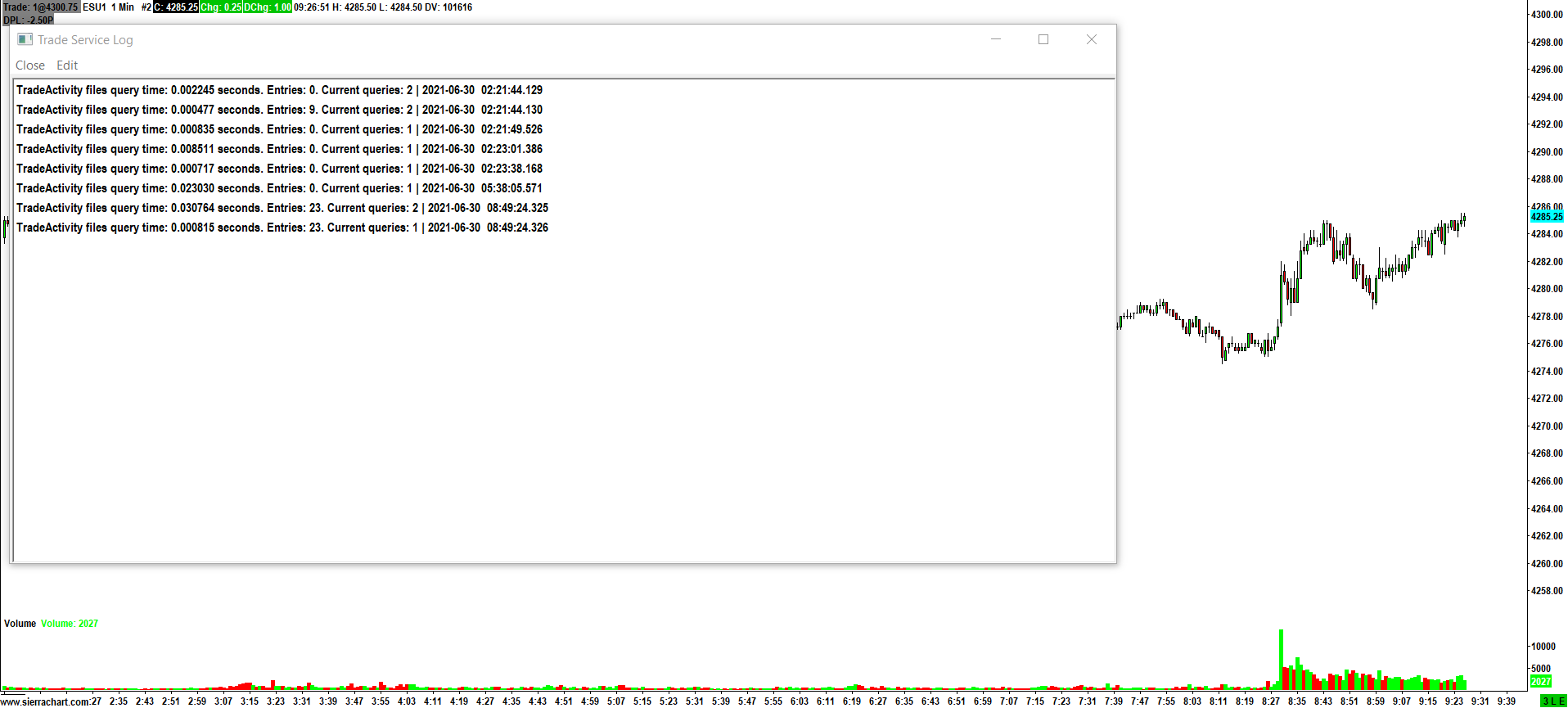

I placed a trade as a test on my SIM account directly on the Sierra chart by right clicking on the mouse which showed up on the chart on both laptops at the same time but it did not show up on the Transact DOM on any of my laptops. I was scared for a while that it will be a live trade as it was showing on my live chart too even though I initiated it on my SIM chart. I closed the trade, it showed up on the Trade Activity Log on both laptops, on my live account it shows as a SIM trade but on my SIM account it does not show SIM on the Trade Activity Log. It is getting very confusing to me. Just to make it even more weird, I placed a SIM trade earlier today on the Transact DOM on my new laptop which shows up only in the SIM account Trade Activity Log but not in my live account Trade Activity Log. Something is definitely not right. Can you check this issue with the Transact support or do I need to take it up with them? I took an image of the Trade Service Log for you. http://www.sierrachart.com/image.php?Image=1625063212765.png |
| [2021-06-30 15:04:36] |
The one thing to keep in mind is that when you are placing trades to the Simulated Live TransAct account, you are NOT in Simulation Mode in Sierra Chart, since those trades are going to the trading service. If you are in Simulation Mode in Sierra Chart, then those trades are NOT sent to TransAct. Given this, if you are still having an issue with trades sent to TransAct, then you would need to ask TransAct about those. If this is just about the Sierra Chart Trade Activity Log, then let us know. For the most reliable, advanced, and zero cost futures order routing, use the Teton service: Sierra Chart Teton Futures Order Routing |
