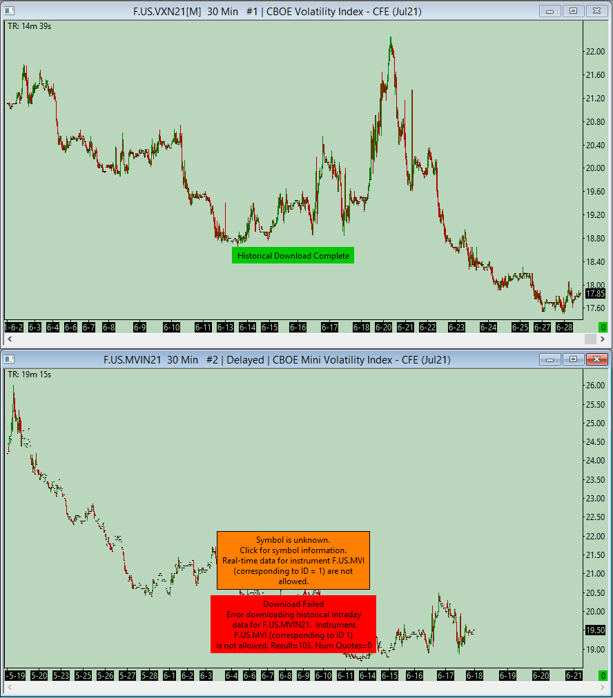

Using CQG with AMP. I had CFE enabled through AMP. F.US.VXN21 and F.US.MVIN21 both worked.
Then I signed up for CFE data from Denali. Both symbols continued working normally.
Today I called AMP to remove all data (CFE and CME).
CME data still works fine, as expected.
VIX futures work, but VIX mini is not working anymore. See:
https://www.sierrachart.com/Download.php?Folder=SupportBoard&download=52265
Date Time Of Last Edit: 2021-06-29 03:16:54
imagevixproblem.png / V - Attached On 2021-06-29 03:05:51 UTC - Size: 60.18 KB - 392 views
[2021-06-29 04:29:20]
Sierra_Chart Engineering - Posts: 25028
This should now be resolved.
Follow the instructions below:

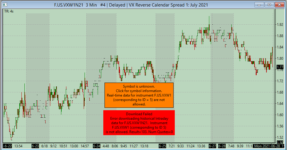

VIX calendar spreads. These are supported natively in the CFE exchange. Worked fine with CQG data. Perhaps similar issue as before? Can these be enabled as well as calendars are a very big part of trading VIX. Picture attached.
Calendar symbols go like this:
cqg symbols
VXW1N21    -1*Jul 21 + 1*Aug 21
VXW2N21    -1*Jul 21 + 1*Sep 21
VXW3N21    -1*Jul 21 + 1*Oct 21
VXW4N21    -1*Jul 21 + 1*Nov 21
VXW5N21    -1*Jul 21 + 1*Dec 21
VXW6N21    -1*Jul 21 + 1*Jan 22
VXW1Q21    -1*Aug 21 + 1*Sep 21
VXW2Q21    -1*Aug 21 + 1*Oct 21
imagevixproblem2.png / V - Attached On 2021-06-29 06:01:07 UTC - Size: 47.08 KB - 347 views
[2021-06-29 06:23:32]
No this is not the case:
Currency value per tick" for F.US.MVI?## it is set at 52
You must have changed it on your side within the Global Symbol Settings. It was set to 1 but that is not correct, it should be 5.
Regarding spreads, we have to set up support for those in the data feed. Currently they are ignored.

[2021-06-29 06:36:24]
Should be about a week.

[2021-07-28 05:04:25]
The calendar spreads are ready, and have been for about two weeks, but we have not set up access to them yet.
The history would be as of about two weeks ago.
There would only be a need to obtain the data through the Denali Exchange Data Feed.
Would there be a mechanism to choose one or the other?
Not exchange by exchange when you are already subscribing to a particular exchange through the Denali data feed.
