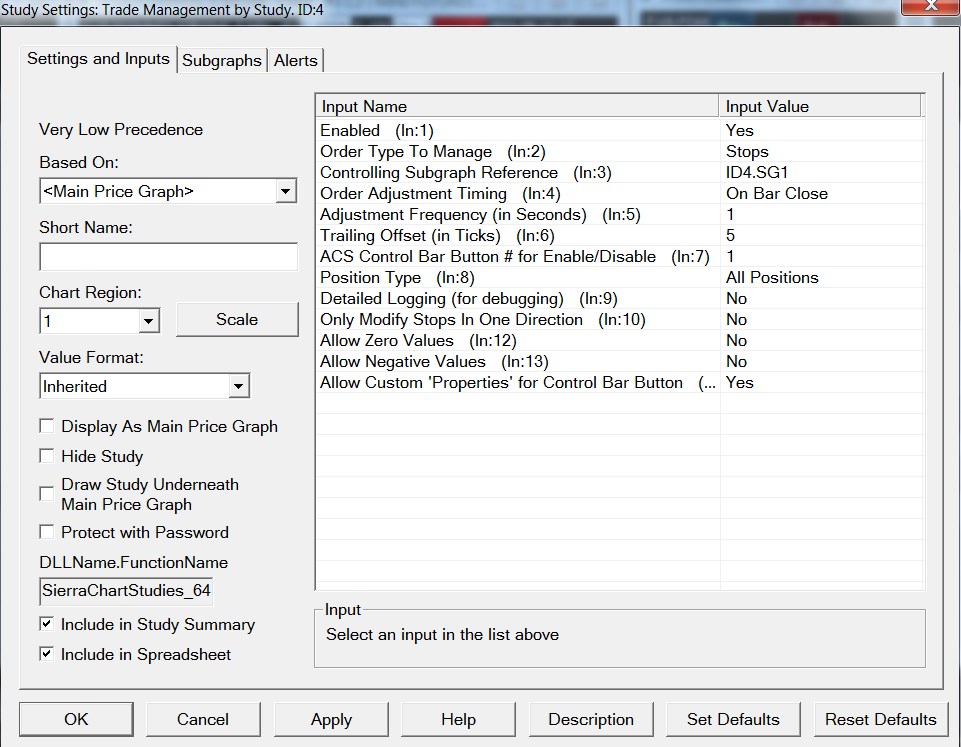

i setup the trade management by study but it does not work
imagestudy.jpg / V - Attached On 2021-06-11 19:15:06 UTC - Size: 163.01 KB - 471 views
imagestudy_1.jpg / V - Attached On 2021-06-11 19:15:54 UTC - Size: 145.11 KB - 379 views

The Controlling Subgraph Reference must be a study other than the Trade Management by Study study.
The Trade Management by Study study needs a price value to which it moves the Target or Stop.
The only study in your Studies to Graph list that returns a price is the Current Price Line study.
You could trail this, but you have Only Modify Stops In One Direction set to No, so it would just move the Stop back and forth 5 ticks from the current price.

The Trade Management by Study study will only move an Attached stop or target of an Open order.
Attached Orders: Study Controlled Targets and Stops
