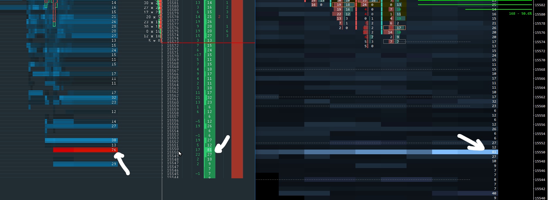

I have seen some differences between what I see on the DOM versus the "Show Quantity Numbers" on the Market Depth Historical Graph. Of course are not huge, however I am wondering why those differences are there. My idea is to getr rid of the DOM during my trading, and just use the Numbers Bars together with the Market Depth Historical Graph in order to have everything togetherand with easy acces to the depth of market and the historical orders.
I am attaching a screenshot with some examples. Can you help me to understand this situation? This instrument is FDAXM21-EUREX (SC Data - All Services)
Thank you

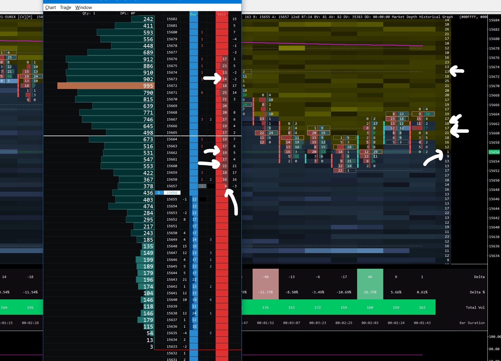

I now attached the DOM and have the chart together with it, having the same studies, and as you can see I see quite different results the more away the levels are from the price. I have the CHart Update Interval set to 0, so it uses the Global (which is 10 ms).
I also checked the Depth Quantity Type to Display After Last Bar and it is set to Last Depth.

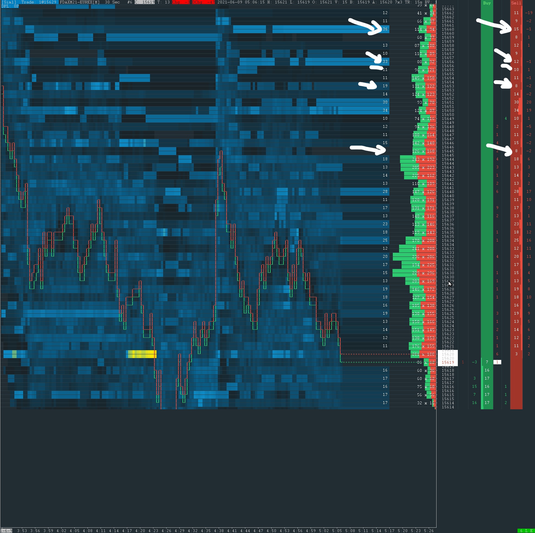

And as you can see on the v3 file, that is even more weird, as in one chart (left) the Market Depth says 76, and on the right, it says 81, which is what the DOM prints on the left chart.
On Market Depth Historical Graph I have set to 60 the Maximum Levels to Display.
Thank you!

The problem you are having is related to the option for Extend Last Known Depth in combination with the Maximum Levels to Display. Since the Maximum Levels is limited to 60, when you extend the last known depth, it is displaying items above/below that 60 that have not been updated. Hence, the numbers do not match.
There are basically two choice. Either turn off the Extend Last Known Depth, or increase the number of levels displayed, and understand that anything outside of the actual number of levels you entered is old information and may not be correct.
