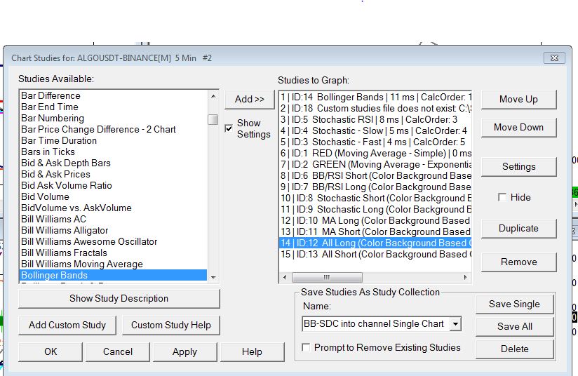

Using the color backround based on alert condition in sierra charts.

We are somewhat confused. The Color Background Based on Alert Condition study will not, and can not, send orders. Are you just looking for the background change and you are not seeing that, but you are getting the audible alert? Or is there something else we are missing in this?
We see that at Line #2 of the list of studies (ID #18) there is a custom study that did not load properly. Is that study the one that actually places the trades based on the inputs from other studies? If so, then you would need to understand why that study is no longer there.

We are still a bit confused. In the list of studies that you show in the image in post #5 there is not a "Trading System Based on Alert Condition" study listed. If the Color Background is performing the same Alert conditions, then that would be why you are getting the alert but not the trade.
If we just missed something somehow and your study is there, then make sure the Alert Condition is Enabled and that the study itself is Enabled. Check over the rest of the Inputs for the study to ensure they are set correctly for what you are trying to do (send to your trade service or Simulation, etc.).

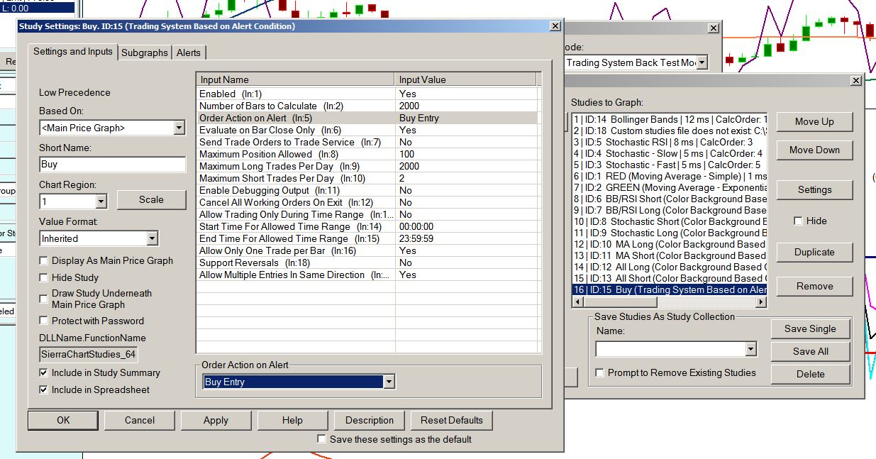

Here is the correct pic. Sorry
imageID 15 setting of trade based on alert system.JPG / V - Attached On 2021-06-09 13:48:21 UTC - Size: 200.97 KB - 366 views

Joe Kurtz - Posts: 12
I have run this many different ways. I do have the color alert and the trade based on alert running the exact same conditions. Are you saying to remove the color based alert conditions?

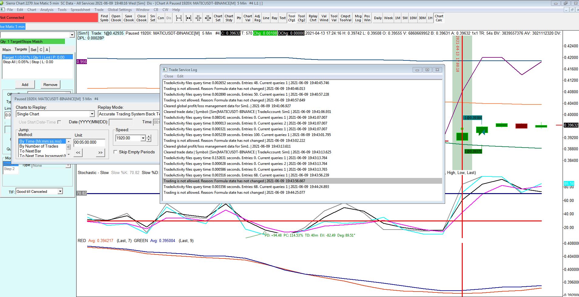

Here is the new version attached pic with trade log. I stopped using the new one because some of my alerts stopped working due to something in the updates. All alerts worked on older versions perfectly. In addition I have my current issue weve been over regarding the trade not being taken in the trade alert backtest study. Here is the new version attached pic with trade log.

[2021-06-15 05:24:50]
Sierra_Chart Engineering - Posts: 25307

Regarding the message at post #18, we have enhanced that and it is now more detailed like this:
Trading is not allowed. Reason: Formula state has not changed. Current state: False. BarDate-Time: 2021-06-14 02:03:00.000000 | 2021-06-15 01:08:39.970
This enhanced logging will be out in version 2274.
