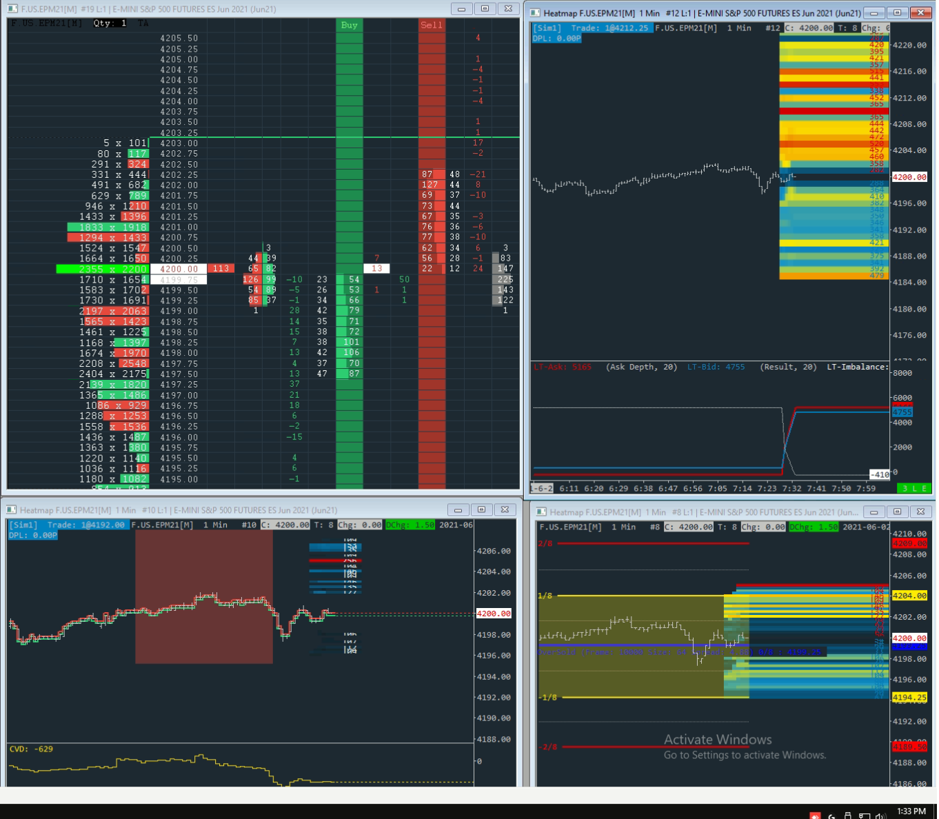

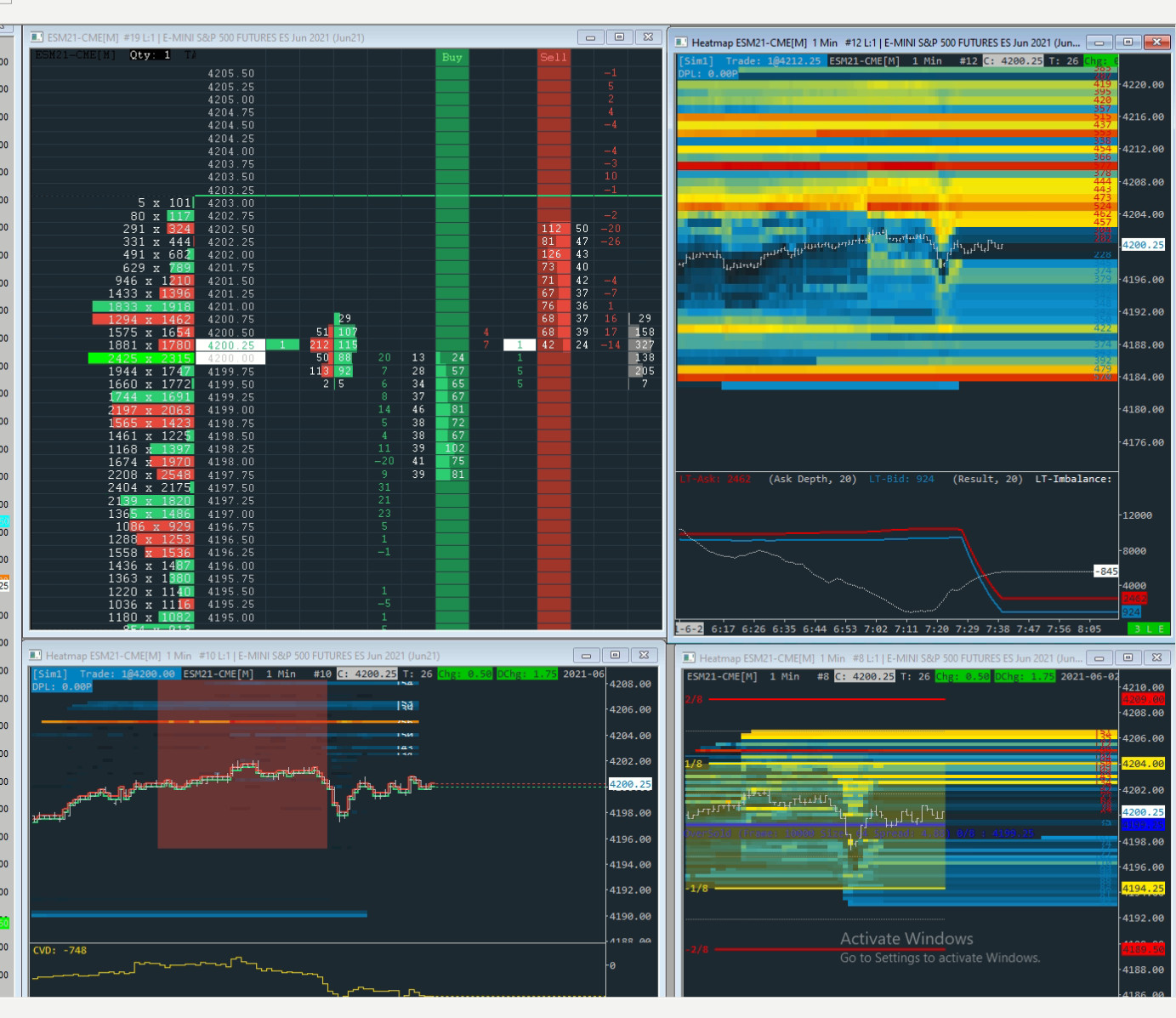

Hi. Thank you so much for the answer. But I am trading just E-mini so the problem I see is a complete different scenario in the DOM and book using the SC-all-data and the CQG on E-MINI. They should be the same. here attached a picture of the two different scenario that I have switching from the CQG to SC-all-data. Sc-all-dataa seems more reliable (look lt-imbalance, for instance).
Please check your own and let me know if you can understand where this difference come from.

imageCQG Data.png / V - Attached On 2021-06-02 12:00:44 UTC - Size: 432.57 KB - 339 views
imageSC-ALL-DATA feed.jpg / V - Attached On 2021-06-02 12:00:56 UTC - Size: 423.35 KB - 375 views
[2021-06-02 13:37:41]
John - SC Support - Posts: 48547
What is happening is that when you are connected to SC Data - All Services, it is automatically downloading the historical Market Depth data that you are missing. For some reason, it is not doing that when you are connected to CQG (we will have to look into this). You can always force the download by following these instructions (particularly step #8):

[2021-06-08 07:10:29]
Sierra_Chart Engineering - Posts: 25432
We do not see any problem with the downloading of historical Market Depth data when using CQG, and the Denali Exchange Data Feed.
Make sure you follow the instructions here:
Market Depth Historical Graph: Downloading Of Historical Market Depth Data
[2021-06-11 08:27:23]
User554446 - Posts: 29
Thank you. It is working now!
