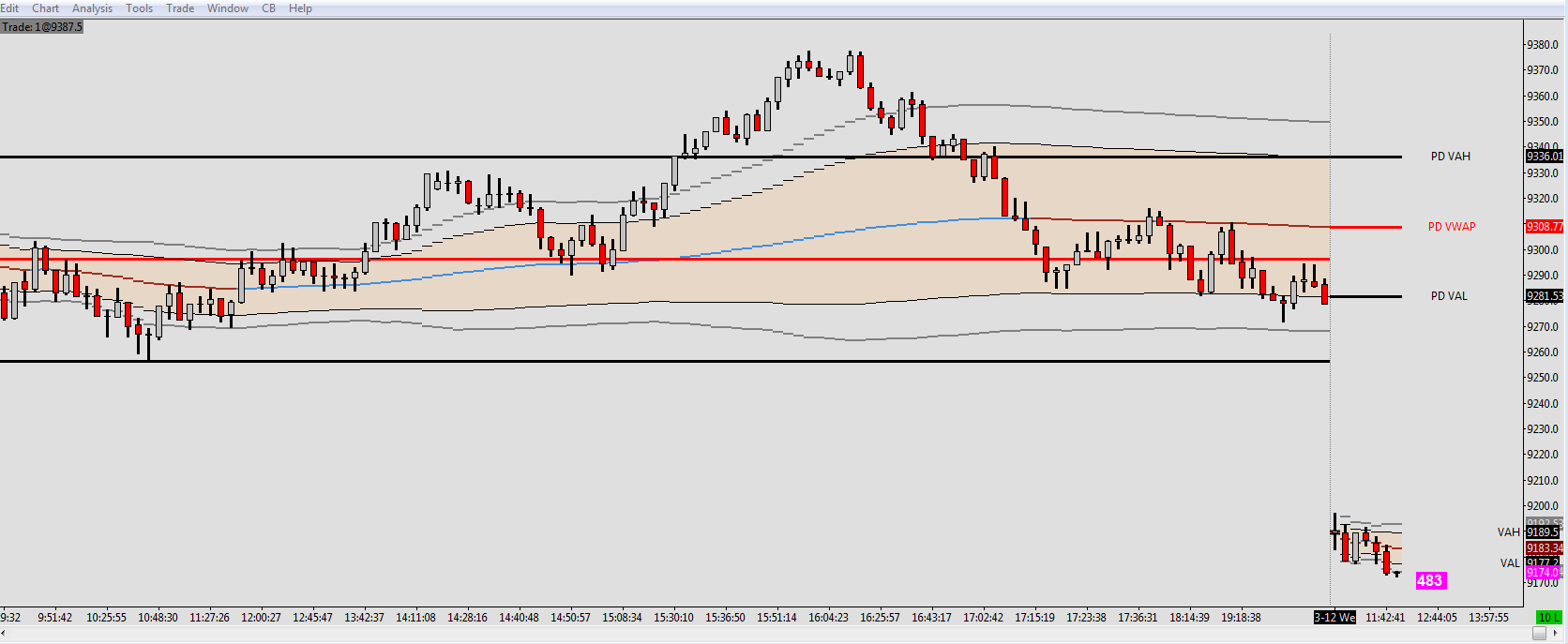

[2014-03-12 10:46:38]
User63439 - Posts: 83
and how do i get the missing data? see chart
imagefdax.png / V - Attached On 2014-03-12 10:46:25 UTC - Size: 45.52 KB - 547 views
[2014-03-13 00:12:40]
We apologize for the delay with responding. We had a higher support load than usual today.
The answer to this can be found here:
https://www.sierrachart.com/index.php?l=doc/helpdetails7.html#RetryDownloadDataInChart
[2014-03-13 00:24:35]
worked, thank you!
[2014-03-13 00:26:20]
Good, and once again we apologize for this. At least now you know where the instructions are to re-download the data. It is a very easy procedure.
