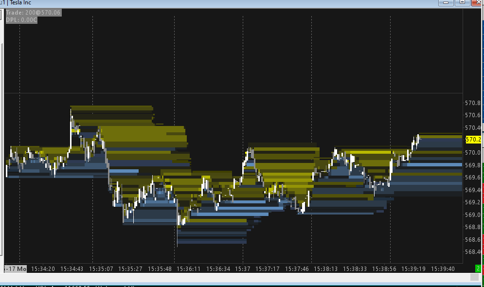

ok , I just upload 2 files ,
One is aapl that I just load, you can see that their is no Market depht on old source but it print with live feed.
On the This file , its TSLA that i have a lot of data on as I am trading it at the moment.
I am just wondering why , It print the data on live feed but not when I load a ticker.
And that Printed data I get when I'm live, Stay in the system.
thanks.

What you are seeing is just the accumulation of the Best Bid and Ask data. If you turn on the Quantity display, you will see that the numbers are going to be very low in comparison to what it should be with the full market depth, since what you are seeing is an accumulation of just 1's.

I see , but it still give me a clue that I like ( I cant have level 2 with any feed at the moment. )
So I wonder why Its not showing when the data is there but its showing in Live market.
[2021-05-17 20:05:36]
John - SC Support - Posts: 48169
Because you are getting the Level 1, Best Bid and Best Ask data. Since you have the Market Depth Historical Graph on, then that is enough to tell the system to record the data. But that data is not available historically. Therefore, you get it when you are connected, but not when you are not.
