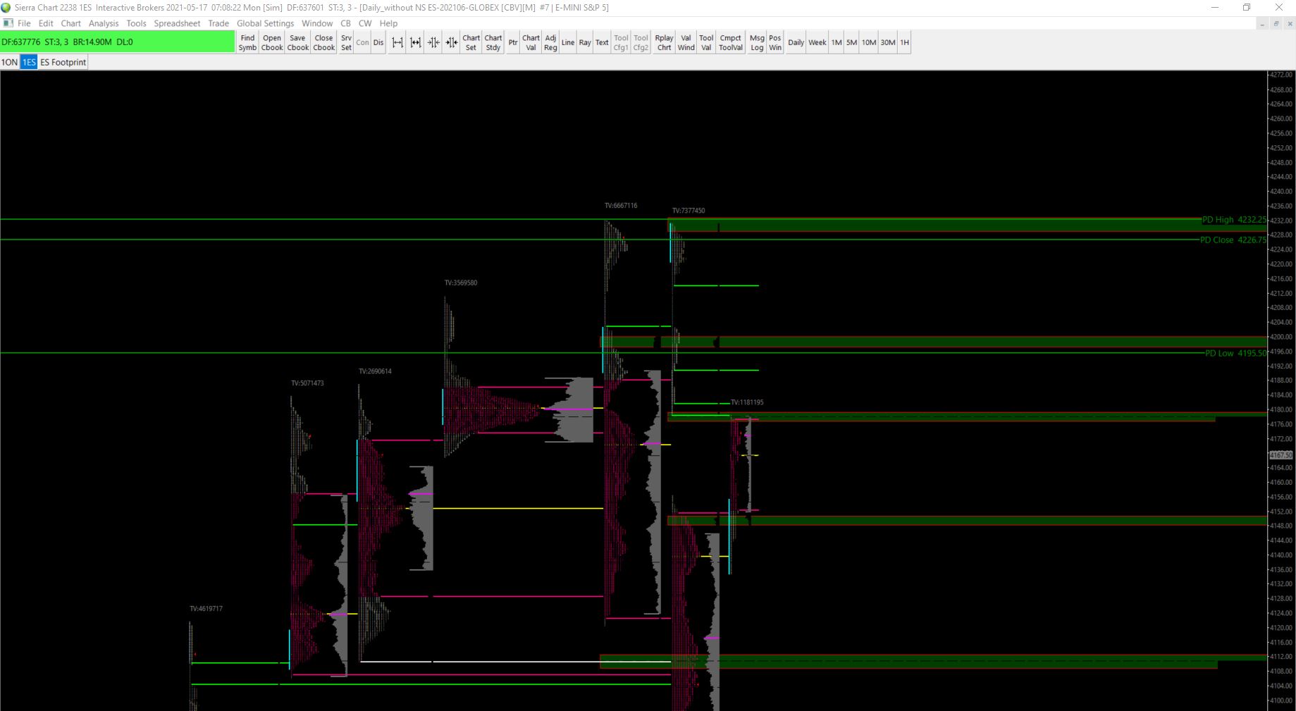

Hello there,
I have some trouble correctly displaying the VP on my daily chart. On the first screenshot you see my daily chart with each day displayed in the form of a market profile and an adjecent volume profile. The view is a little bit more zoomed in than the view on the second screenshot.

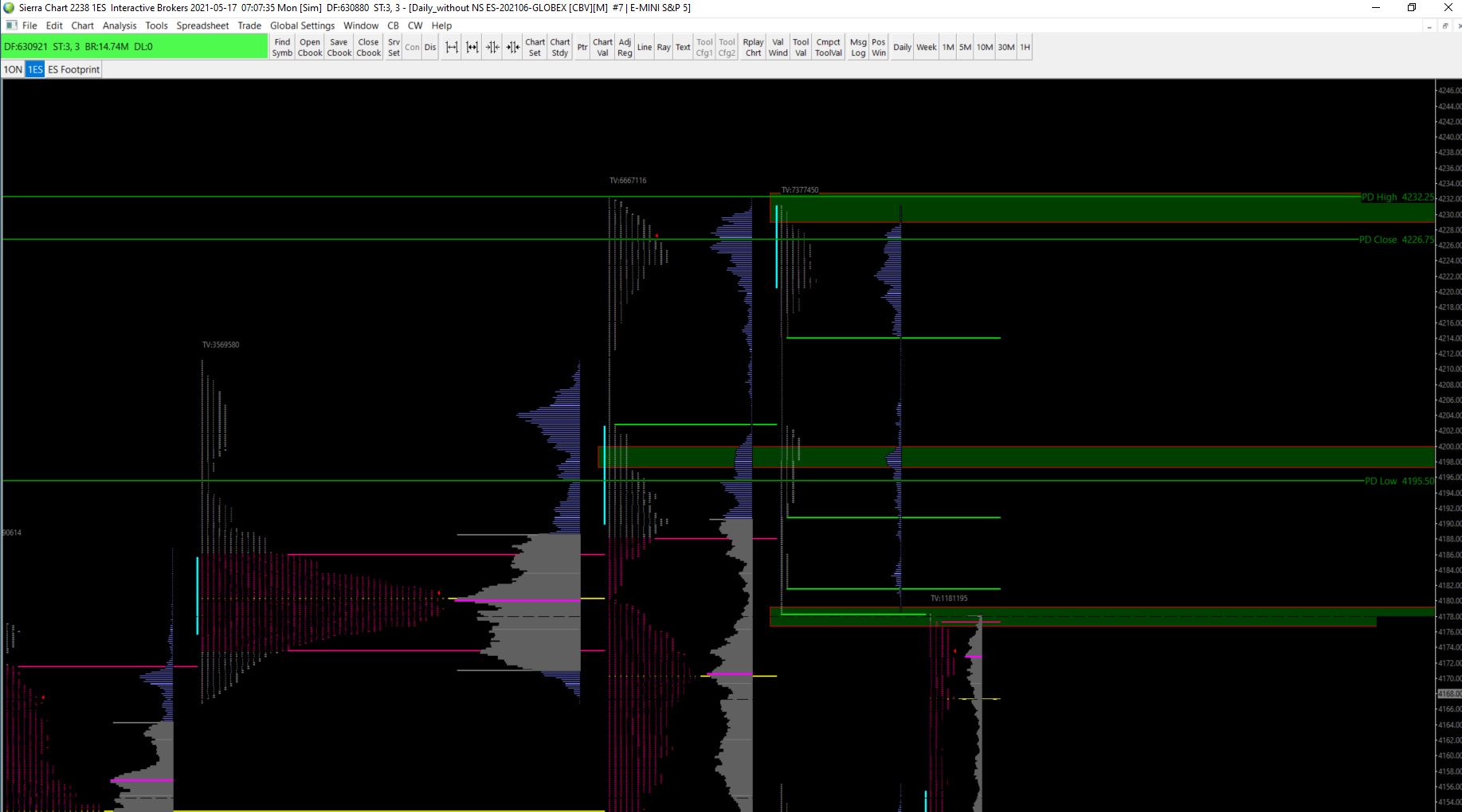

My problem is that when I zoom out, the blueish bars of the volume profile (which do not belong to the value area) suddenly disappear as can be seen on the second screenshot.

[2021-05-17 17:33:58]
John - SC Support - Posts: 48169
Get us a copy of the chart when it is showing the problem by following these instructions:
[2021-05-17 20:21:17]
maxm1987 - Posts: 136
Hi there,
thanks for the reply. Attached is the file. I did what the instruction told me. I tried to strip down any unnessary studies but I couldnt delete the TPO profile as this would have erased the VP as well.
attachment1ES.Cht - Attached On 2021-05-17 20:19:44 UTC - Size: 57.16 KB - 357 views
[2021-05-17 21:44:54]
The reason for what is happening is because you have the Subgraph for Volume Bars Outline and Fill Color set to a Width of 0. Therefore, it is not putting in a color for the outline, but the outline itself is still taking up small amount of space. Then, when we draw the rectangles, the outline is drawn last, therefore when the VbP is very small, you are just seeing the outline, which is the same as the background, hence it just disappears.
If you make the outline a Width of 1, it will solve the problem. If you really want it to be a different color, then you can change the colors for that subgraph to what will work best for you.
