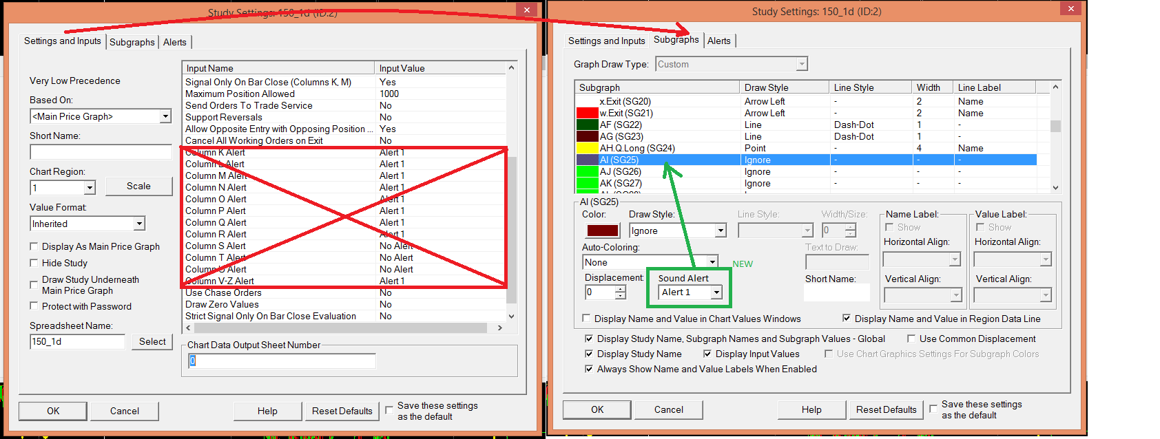

in a study "Spreadsheet System for Trading" currently there are up to 60 "number of formula columns", but settings for "Alert columns" restricted up to Z column.
I have no chance to disable sound alert if I have in column AI=C3+10 and want just to show its value on a chart. Today, on each bar it's recognized as not false and triggers sound alert. Basically I can't use full power of 60 formula columns..
Please see attached screenshot for what I mean.

imagesound.png / V - Attached On 2014-03-11 21:28:35 UTC - Size: 80.53 KB - 659 views

We understand what you are requesting. We will see about this.
For now set the Column V-Z Alert input to No Alert.

Here is a workaround:
http://www.sawtoothtrade.com/tip-6.html

namlem - Posts: 94
Hi Tom,
I've read what you suggested (section 3), but still can't make it working.
Maybe problem due to the fact that I have one "Spreadsheet System for Trading" for 3 different charts,
thus Sheet1, Sheet2 and Sheet3 have formulas in cell AA3.
When I'm setting up "Spreadsheet System for Trading" for particular chart, in Alert tab for this study, I tried both and =AA3 (I use .NET version of SC) and =ID2.SG17, but nothing works. (ID2, is id of the study).
Did I miss anything?
Thanks for your support, Tom.
[2014-04-01 19:33:00]
Sawtooth - Posts: 4359
The =ID2.SG17 needs to be on the Alerts tab of any other study (not the spreadsheet study), or on the Alerts tab of the Chart Settings.
Date Time Of Last Edit: 2014-04-01 23:36:09
[2014-04-01 20:49:52]
namlem - Posts: 94
You are right, I missed that "any other study" word! and thought if ID2.SG17 has value TRUE it will trigger an alert...
thanks one more time!
