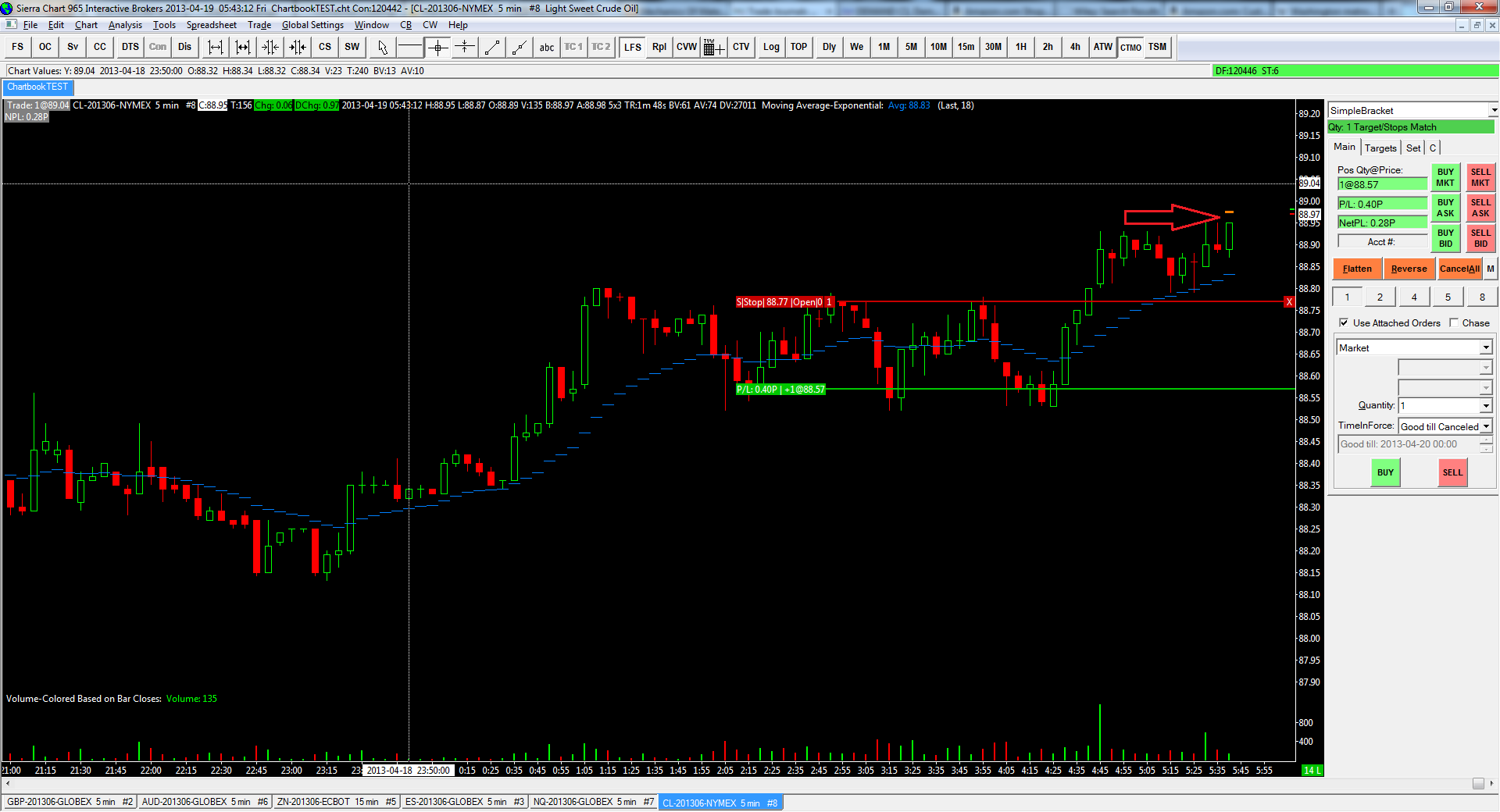

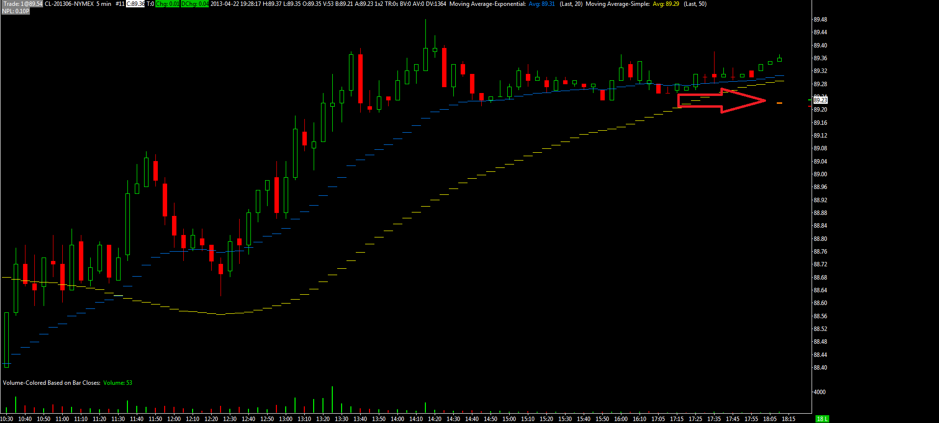

Candles are lagging behind by 3-5 seconds regularly and sometimes they disappear entirely. The bid/ask and midpoint bars reflect the live data, but the candles are severely lagging. When this starts to happen, the only solution is to restart the program.

[2013-04-22 05:50:15]
Most likely this is because you have Record True Real-time Data in Intraday Charts enabled:
http://www.sierrachart.com/index.php?l=doc/IB.php#TrueRealTimeData
Disable it, if it is not acceptable.

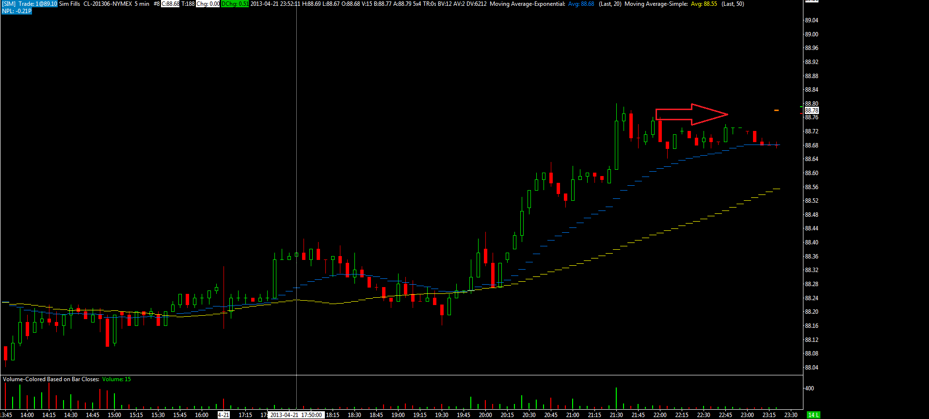

Miracle 007 - Posts: 17
I tried your fix, but still getting candle lag. Now the candles are not drawing at all. See attached pics. I thought it was the IB data feed, but I'm not using IQfeed and still having the same problem. So it must be in the chart program.

[2013-04-23 00:37:03]
Please refer to help topic 3 here:
Http://www.sierrachart.com/index.php?l=doc/helpdetails3.html
Maybe you aren't understanding whats going on. The data is feeding the chart just fine. I know this because have "show bid/ask lines" enabled. The bid ask IS correct from data feeds from both IB and iQFeed. The problem is not the data, the problem is the chart is not drawing the data. The bid/ask lines are basically bouncing up and down showing me the actually price, but the candles are not being drawn.
[2013-04-23 01:21:48]
Yes we do understand. Help topic 3 explains every single possibility of what it could be. Including possibly the Session Times filtering out the data.
This could not be a problem within Sierra Chart itself.
