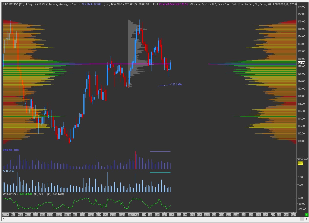

[2021-03-27 17:07:08]
wallstreetsson - Posts: 80
Thanks so far.
what i still dont get is why is there a difference in the shape of the "mobile" volume profile (Grey) in the middle of the charts when i switch from Historical to Intraday chart?
Also before changing the Routing to CQG, in this example, for KC Future, it had more days back for loading for Intraday chart, then it has now.
imageKC_His.jpg / V - Attached On 2021-03-27 17:06:30 UTC - Size: 169.93 KB - 409 views
imageKC_intra.jpg / V - Attached On 2021-03-27 17:06:39 UTC - Size: 171.79 KB - 375 views
[2021-03-29 14:32:53]
John - SC Support - Posts: 48003
Refer to the following:
Volume By Price Study: How Volume by Price is Calculated for Historical Daily and Higher Timeframe Charts
Changing the Service will not have any impact on the days that are loaded since you are getting your data from us. If you are having an issue with this, let us know specifically what the problem is.

[2021-03-29 17:30:25]
Sorry, refer to the following:

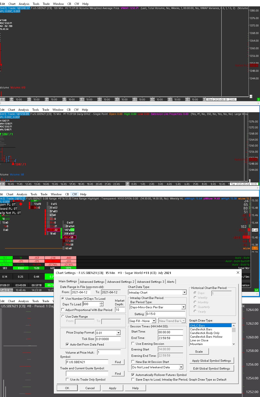

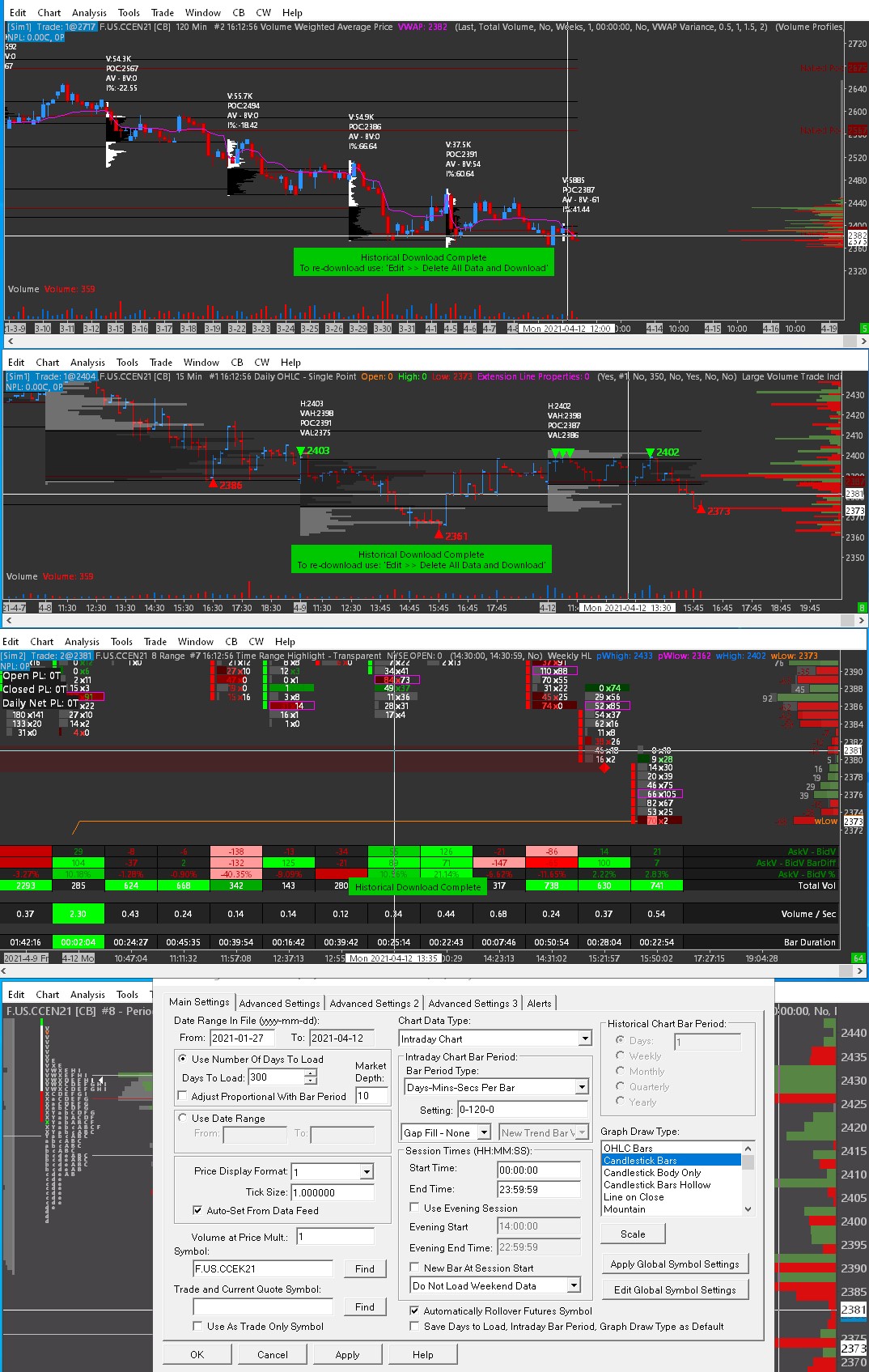

[2021-04-12 14:25:39]
is there a way to increase Intraday days loaded for Softs like Sugar Cocoa etc?
for example, SB shows only current day , while Cocoa shows a lot days more - but i still need more days of intraday accurate tick data. Delayed data is enough.
imageCC.jpg / V - Attached On 2021-04-12 14:24:00 UTC - Size: 443.91 KB - 382 views
imageSB.jpg / V - Attached On 2021-04-12 14:24:15 UTC - Size: 301.47 KB - 384 views
[2021-04-12 18:27:02]
Historical Intraday Data (Missing Data / Download Errors / Viewing More Data): Downloading/Viewing More Historical Intraday Data
[2021-04-12 19:55:43]
There may be a limit to the maximum number of historical Intraday days of data available from the Data or Trading service you are using. If you use a setting that is over the limit, only the maximum number of historical Intraday days of data supported by the server will be downloaded.
What is limit for ICE US?
[2021-04-12 21:05:22]
Refer to the following information for how much historical data is available from Sierra Chart:
Sierra Chart Historical Data Service: What is Included
But, keep in mind that since you are not setup to get the Real-Time data for the ICE from us, you would be getting that data from CQG, and we do not know how much data they have available.
