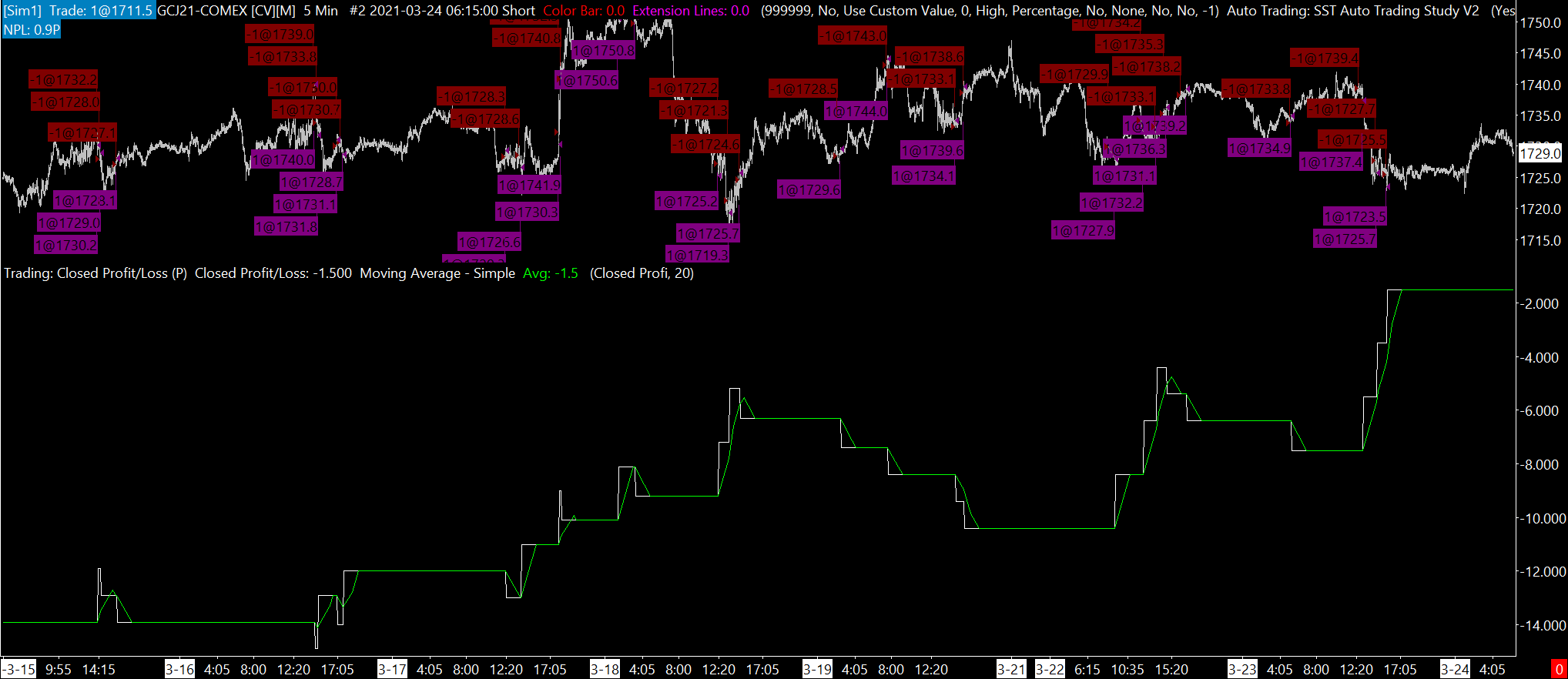

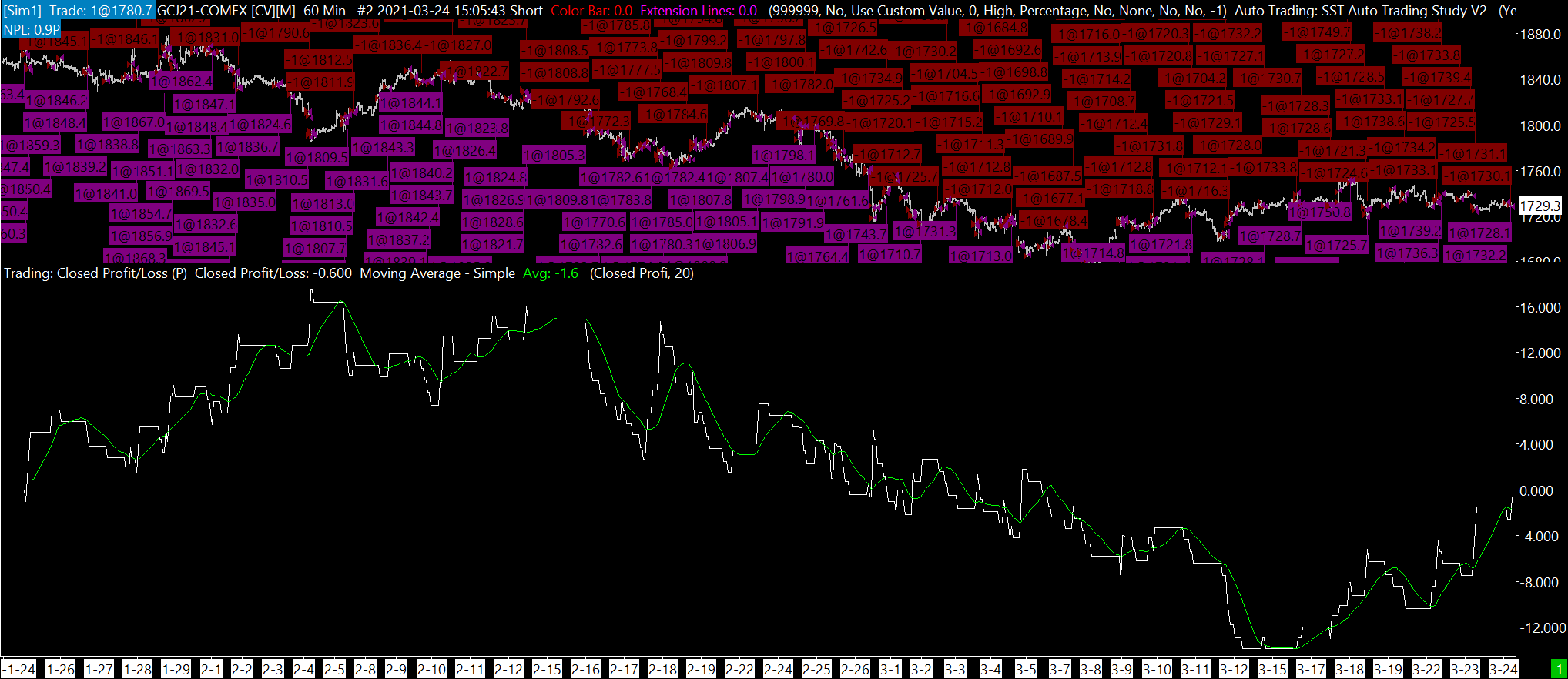

I'm having a problem with SMA based on Closed Profit/Loss subgraph.
As far I looked this up it seems the SMA pulls data from each consecutive bar, not from every P/L change. This makes it almost precisely same SMA line as P/L line.
Here is the same backtest put on different timeframes:
http://www.sierrachart.com/image.php?Image=1616670620231.png
http://www.sierrachart.com/image.php?Image=1616670738528.png
Do I have to find coder able to pull Closed P/L data directly and make SMA out if this instead of pulling it from each bar?

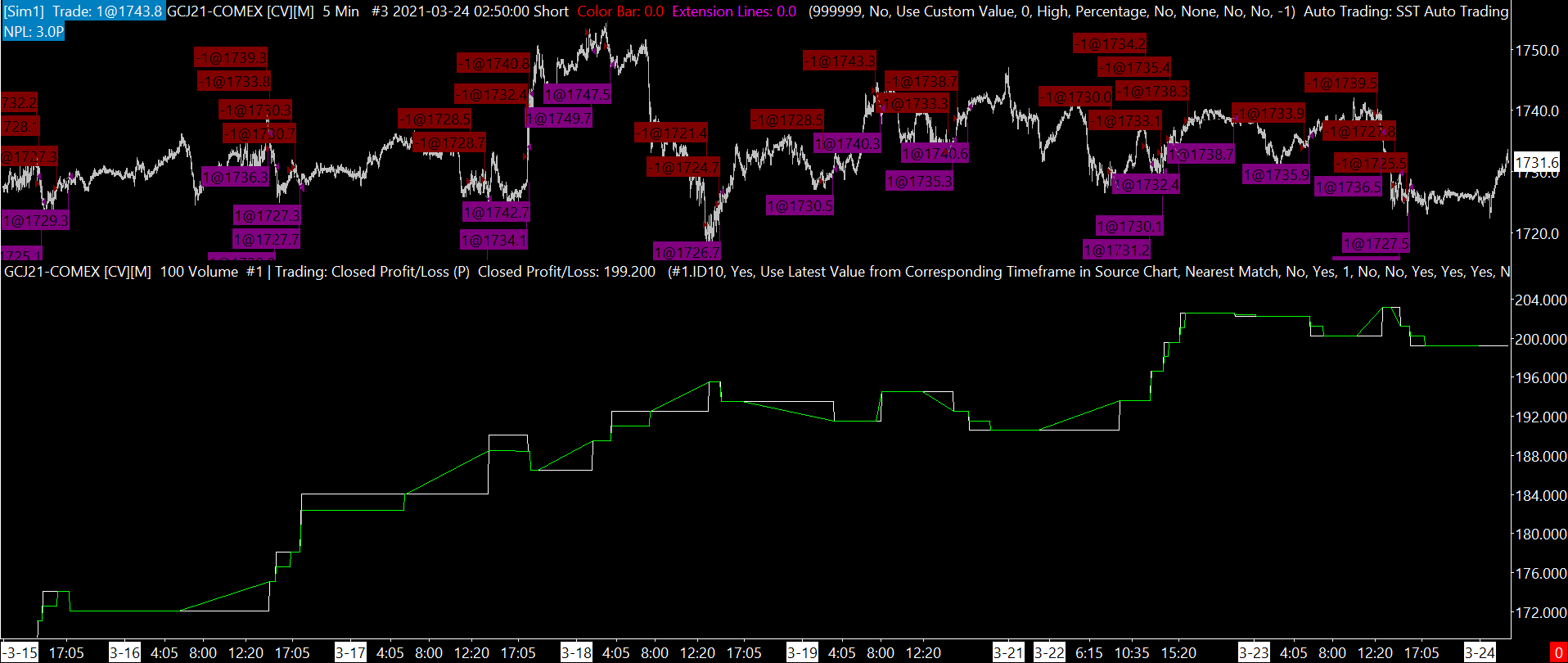

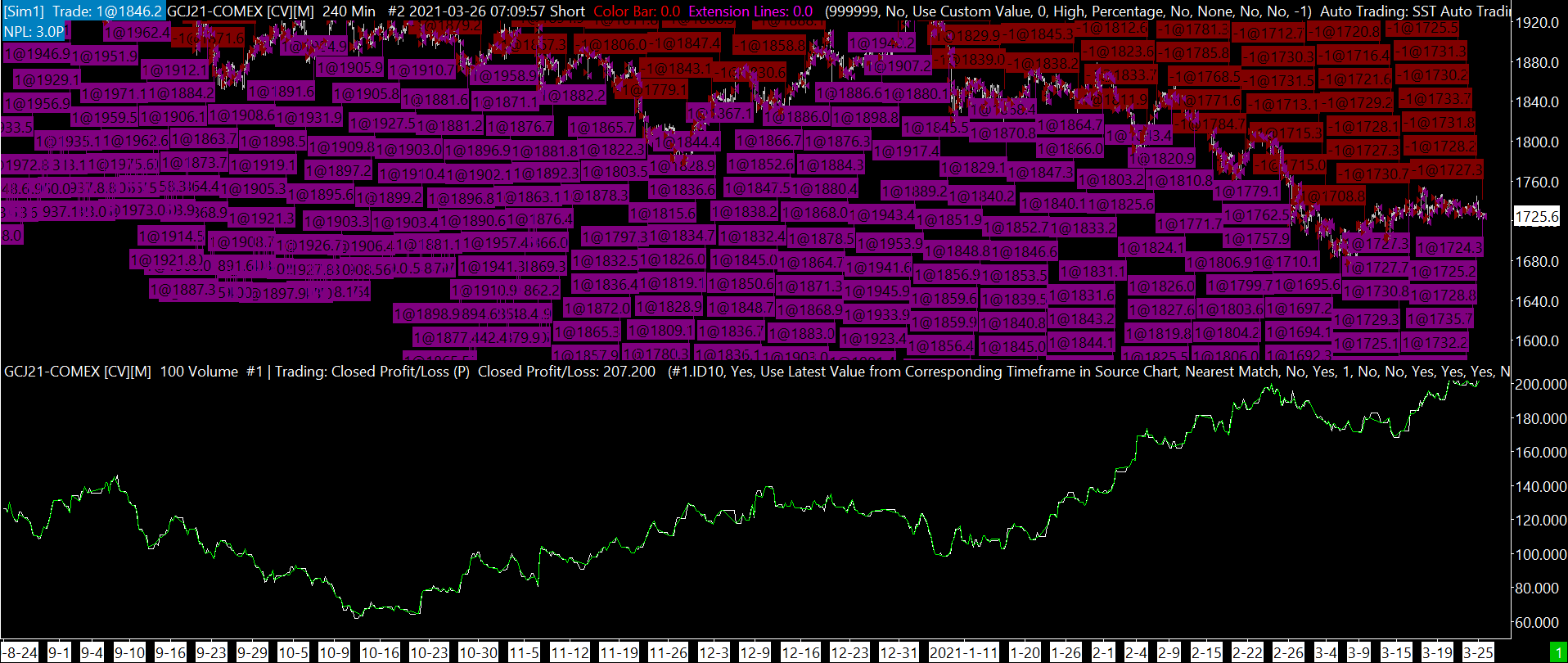

@tomgilb thank you for your help, unfortunately this does not seem to work either.
Here's an outcome of what you advised:
Backtest made on volume bars, then I overlayed it to 5min and 4h chart which look like this:
http://www.sierrachart.com/image.php?Image=1616770691480.png
http://www.sierrachart.com/image.php?Image=161677043053.png
Green line supposed to be a SMA300, but in my opinion is nowhere close to it.
Can someone explain what's going on?

Sawtooth - Posts: 4359
Suggestions/comments:
1.
- When using the Study/Price Overlay study to/from a non-time-based chart, the 'Data Copy Mode' needs to be set to 'Earliest...'
Auto Trade System Back Testing: Performing Back Testing on a Trading System That Uses Multiple Charts
- You can also try the different settings of 'Bar Time Matching Method'.
- 'Fill Blanks With Last Value' will need to be 'Yes'.
2.
Try overlaying the the Closed P/L study to the 5min and 4h charts, then use the Spreadsheet Formula/SMA skip zeros on the overlaid P/L study.
You'll have to adjust the SMA's length to something equivalent.
3.
A 100 volume chart of the GC will have mostly shorter timed bars than 5 minutes, so when you overlay to a 5min or 4h, you will have blank times that will be filled with the Last value. This will give the appearance of flat segments.
