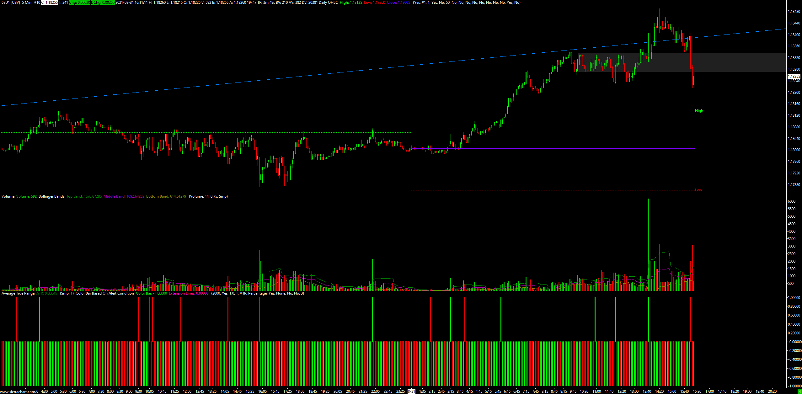

Hi Tom, thx for the detailed answer! i did follow your instructions, but still, the chart looks a bit off from how i would like to appear. for example, i would want that the bars that match alert criteria get only different colour and other bars to stay the same. i played around with the settings for a while, but was not able to fix this issue.
Do you have some idea how this could be fixed?
I attach image of how it looks now.
http://www.sierrachart.com/image.php?Image=1630415474900.png

I can't tell from the pic what needs to be fixed.
The color bar study should be below the ATR study in the studies to graph list.
