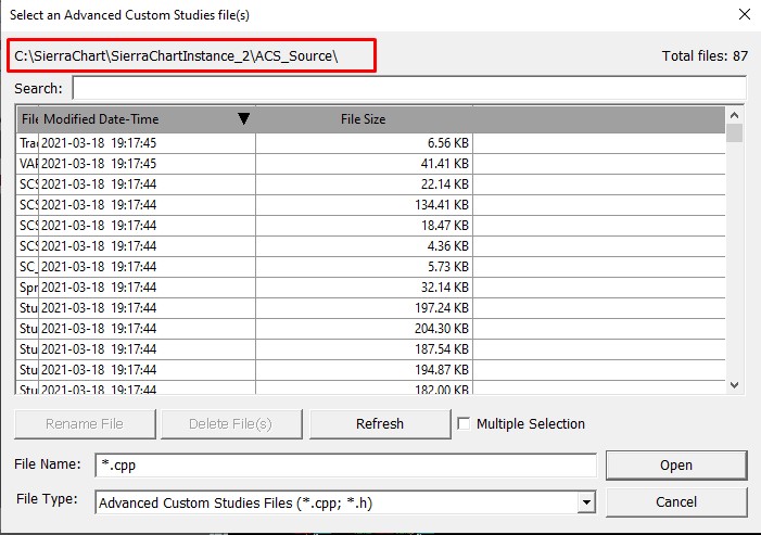

[2021-03-19 11:05:43]
User61576 - Posts: 458
is there any way to set the ACS source for compiling to be the original folder?
imageScreenshot_8.jpg / V - Attached On 2021-03-19 11:05:01 UTC - Size: 90.63 KB - 312 views
[2021-03-19 14:16:46]
John - SC Support - Posts: 48279
You should do the compiling from the Main instance. That will ensure that the study is copied to the sub-instances when they are started.
But there is no way to change the folder that is used for compiling.
[2021-03-19 14:21:06]
on every restart it will copy the dll/acs?
[2021-03-22 14:28:57]
Yes.
