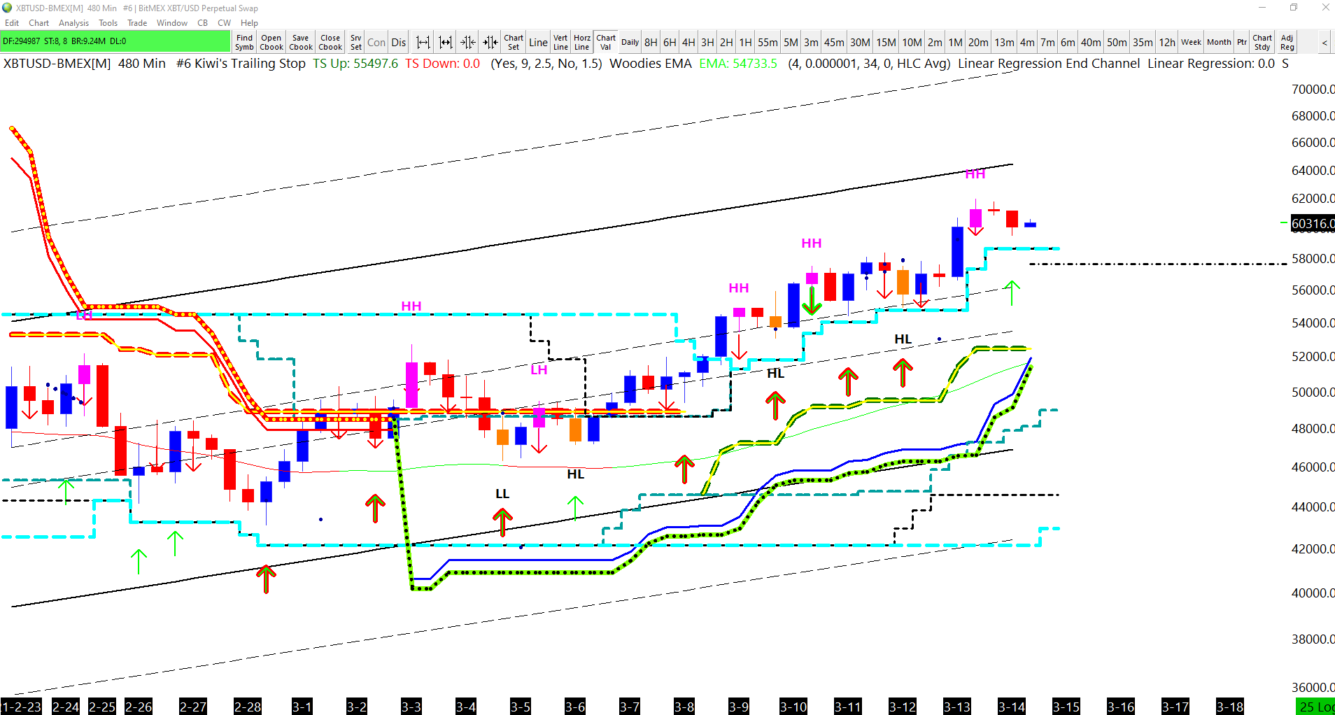

The Market Structure Low High signal (MSL/MSH) appears 3 candles later. Can I make it appear on the next candle?

Thank you for your response. Let me clarify my question. . . the Market Structure HH, LH, HL or LL indicator only shows up on my chart after 3 candles have occurred. After 3 candles have occurred I then see the indicator 3 candles back. How do I make it appear on the next candle in the present NOT in the past? For example, on the attached chart, the very last HH (in pink) did not appear until the very last blue candle.
imageScreenshot (6).png / V - Attached On 2021-03-14 14:42:44 UTC - Size: 88.88 KB - 477 views

You will need to modify the source code of the study to meet your requirements.

[2021-03-16 16:12:19]
John - SC Support - Posts: 48279
Refer to the following for how to search for the source code for a specific study:
How to Build an Advanced Custom Study from Source Code: Searching for Source Code for Sierra Chart Built-In Studies
Then refer to these instructions for the basics you need and how to compile:
How to Build an Advanced Custom Study from Source Code: Step-By-Step Instructions
