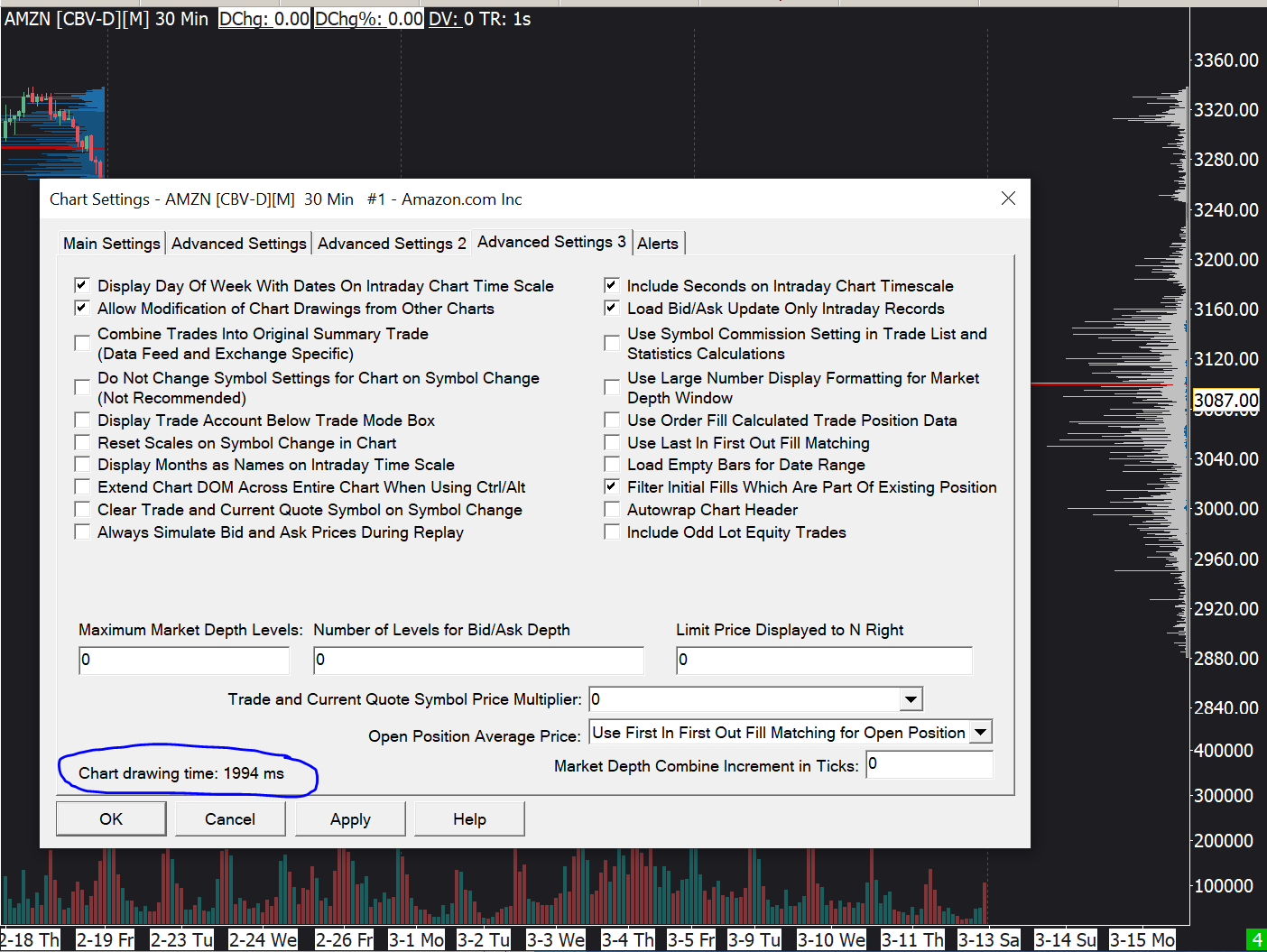

I'd like to follow up with some stats to show how bad this problem is for a stock like AMZN. I literally can't use SC because the lag becomes so bad due to the excessive computation in the VbP study for so many tiny price levels. Please understand this is a 2700X (8 core, 16 HW thread), 32GB, SSD, 4GB GPU, etc... machine. Other processes are not affected, this is purely SC.

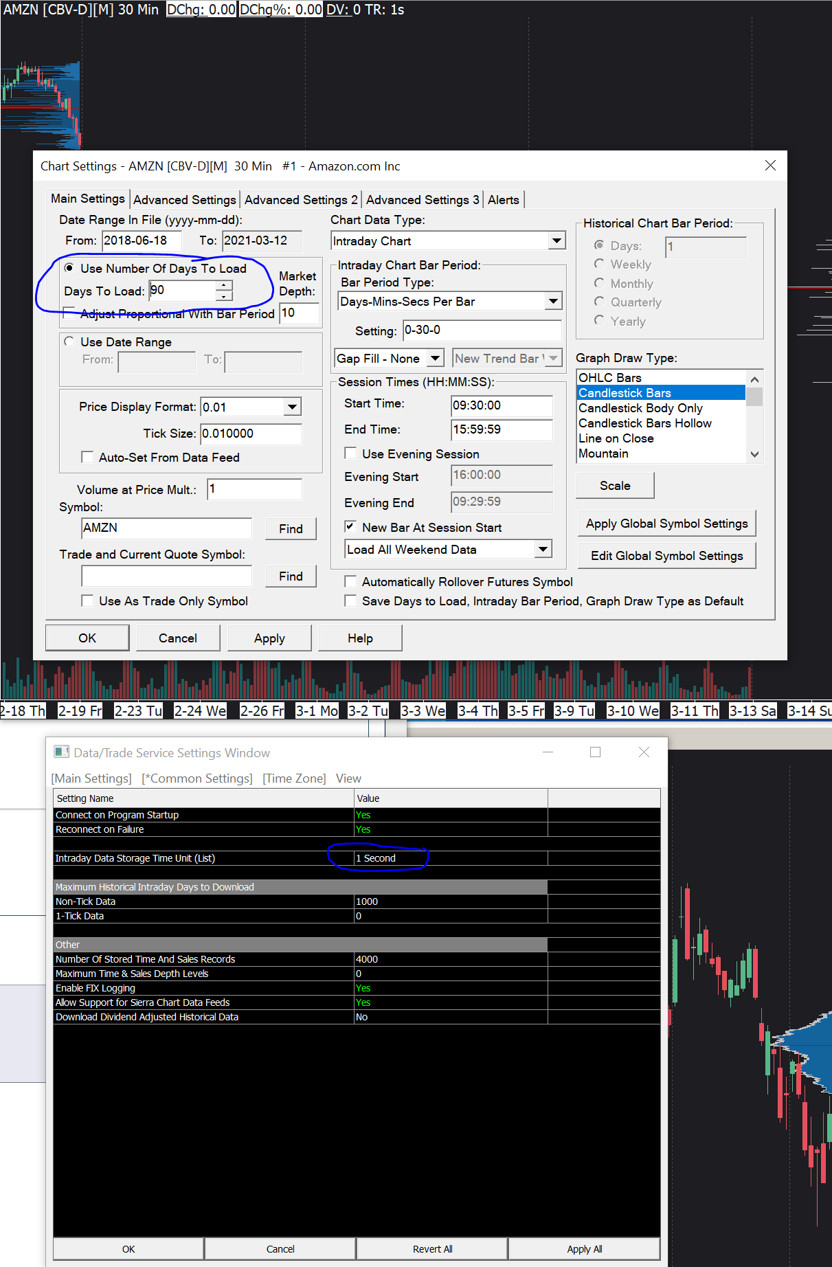

The intraday data granularity is 1 second, so we're not dealing with a fixed number of data points per day. The chart is showing 90 days, 30 minute bars, and has three profiles on it.

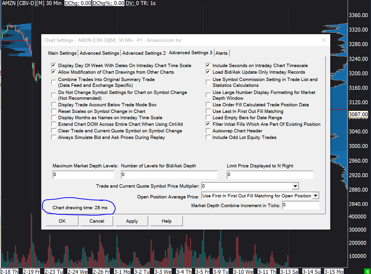

It takes *2 seconds* for the chart to render when the profile is set to a 1 tick granularity.
Now, changing the tick value to something more sane for AMZN, 100 ticks, the render time goes down to 28ms. Additionally, the profiles are unusable at a 1 tick granularity because the data is not smooth at all. When using a 100 tick setting, it looks "normal" and is usable.
