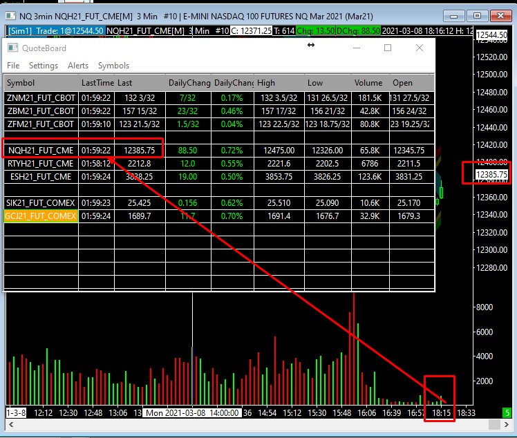

pls check my attached screenshot (3 min nq chart + quote board) and my chart setup
NQ latest feed time is correct though it's not displaying correctly on the chart (the time?)
the ES data is ok as well as on the chart
pls advice

Just to make sure we understand, the correct time of the charts when the image was taken was 01:59:22, but the NQ chart had not updated since 18:15 of the previous evening?
If this is correct, then try to force a redownload of the data in the chart by following these instructions:
[2021-03-09 18:39:46]
User61576 - Posts: 458
thanks. worked. why did this happen?
[2021-03-09 20:03:42]
We do not know. For some reason the chart was simply not updating, which is what you forced it to do by selecting that option.

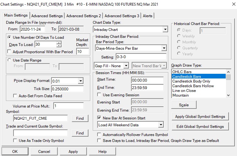

thanks for the additional info though the time for that chart was set exactly as in here
Intraday Chart or Chart Bars Not Updating | Blank Intraday Chart | "Currently no data to display" message for Intraday Chart: 3.3 - Session Start Time and End Time not Covering Current Time
