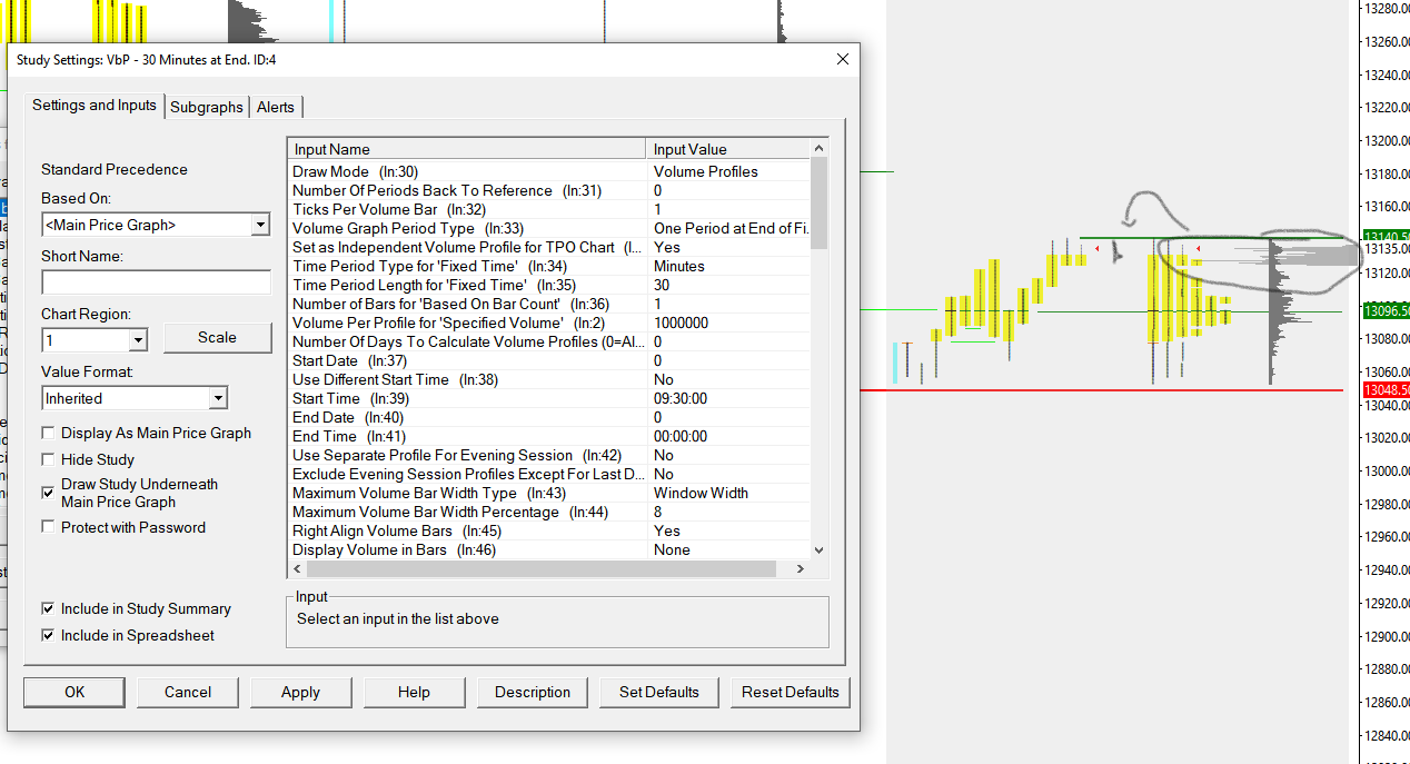

Please, is it possible to have two volume profiles?
- one for current session
- another for current period within the session (to go with own column/standard profile on TPO)
If it's not possible
Right now, I have this (attached)
- it doesn't seem to reset for each period.
- My drawing labels on right edge of screen cover it up.
Thank you for your help!

[2021-03-03 17:36:16]
What you have done is correct in order to get the latest 30 minute Volume by Price profile.
If you also want to add the Current Session, then you would want to make sure you follow these instructions:

[2021-03-03 18:50:34]
HumanX - Posts: 8
Thank you, John.
Please,
what can I change to have the 30 min volume profile reset and start over at begin of every 30 min period?
Also, have it in main chart like my session one in main screen area. (Not aligned it to right of chart?)
Its ok if it's not possible. Just want to be sure.
Date Time Of Last Edit: 2021-03-03 19:04:16
[2021-03-03 19:07:32]
What you have selected will always give you the most recent 30 minutes. As time goes on, the new trades are added and the ones that are then over 30 minutes old are removed. So it's a rolling 30 minute window.
If you wanted to get a static 30 minute view, then you would need to specify the Start and End Times, but then you would need to continuously update it as you wanted to see a new period.
There is no way to get the Volume by Price for a special period within the main graph along with the TPO profiles. You can get the Volume by Price that is associated with the same time frame as the TPO, but that is the only one. Other VbPs have to go to the side.

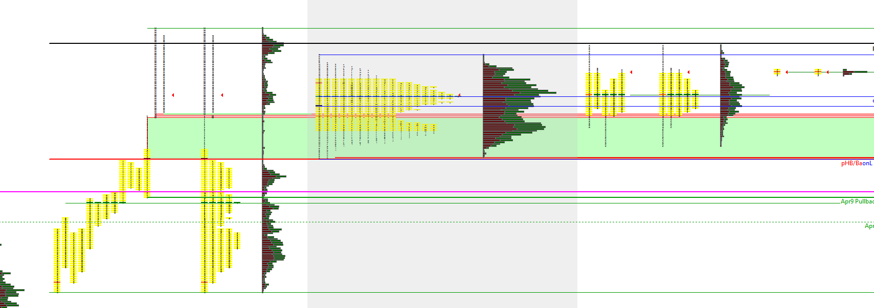

HumanX - Posts: 8
Since I am using TPO in my chart already..using Split profile on every half hour..
Good enough.
But if you can think of anything else that might help (basically like clean easy chart to watch)..grateful for any further suggestions.
imageSplitProfile.png / V - Attached On 2021-04-12 16:04:04 UTC - Size: 33.11 KB - 344 views
[2021-04-12 18:52:34]
Short of making your TPO charts 30 minutes each, there is not much else we can do. What you are looking is a new feature that we would have to add support for. And truthfully, we are just very very busy right now, so it's not something that we can get to.
