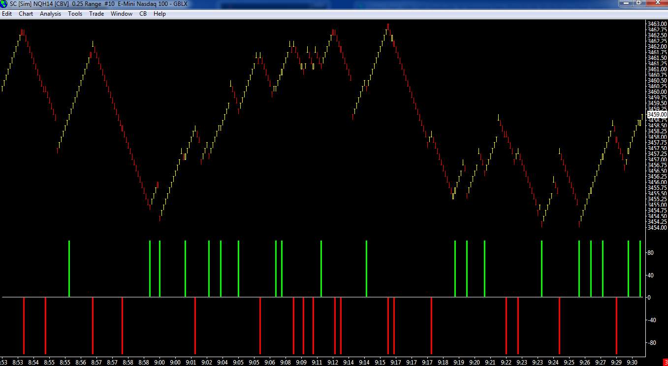

[2014-03-04 08:23:52]
batman_ - Posts: 190
Support
These two images are sample of tick volume missing taken on 2013-12-13 as shown in central tome zone 0830 to 1130 for NQH14 in SC Historical Data.
This missing tick volume data started from 2013-12-13 to 2014-02-11.
imageNQH14_2013-12-13_central_time_zone (2).png / V - Attached On 2014-03-04 08:21:17 UTC - Size: 61.21 KB - 518 views
imageNQH14_2013-12-13_central_time_zone.png / V - Attached On 2014-03-04 08:21:32 UTC - Size: 63.23 KB - 624 views
[2014-03-04 08:49:02]
We cannot help with charts like these. They have to be charts with bars based on Minutes or Seconds. And they should include a standard Volume study.
Otherwise, it is very hard for us to go through a reverse analysis to try to understand why you see what you do. You are not aware of the high degree of complexity involved with range bars.
