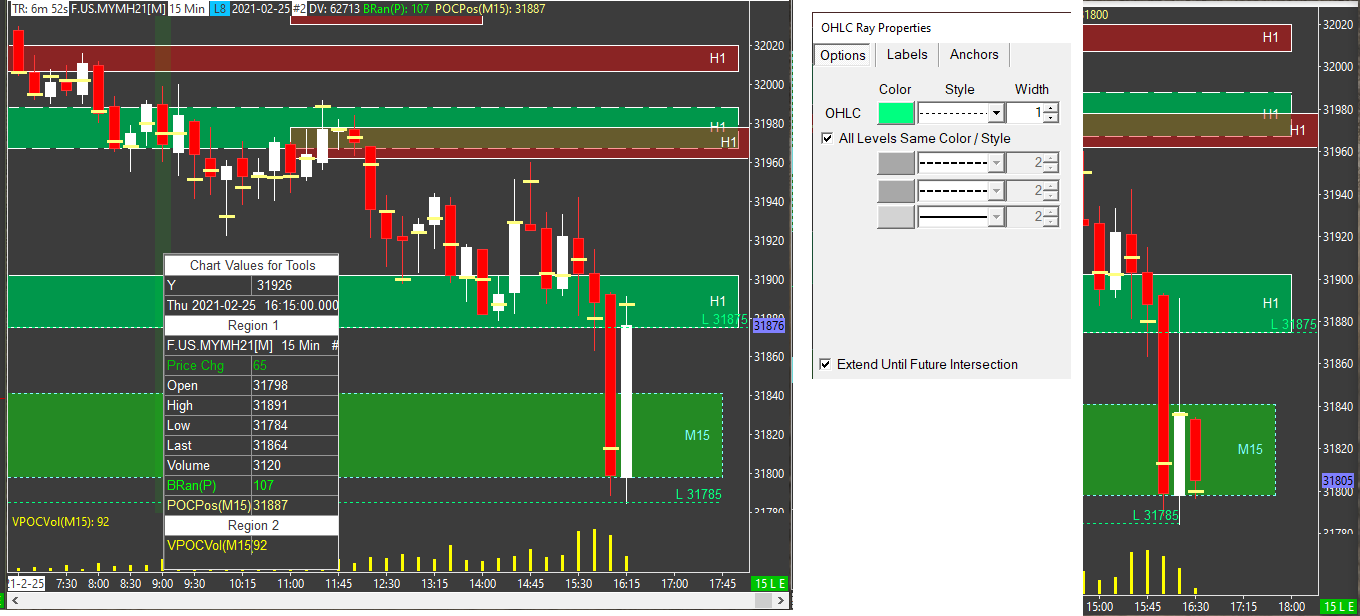

I noticed two things
- "Extend Until ...." only works as soon as the candle has closed.
- M3 and M1 Chart are linked to M15 with the option "Copy Chart Drawing ...", but in this case they are not displayed. If you remove the checkmark at "Extend until ...", the OHLC_Ray is displayed.
Ver.: 2232
Date Time Of Last Edit: 2021-02-25 16:06:59
imageOHLC.png / V - Attached On 2021-02-25 15:41:06 UTC - Size: 66.6 KB - 553 views
[2021-02-25 17:30:47]
John - SC Support - Posts: 48114
We do not understand this. If the option for "Extend Until Future Intersection" is set for the OHLC ray, then as soon as you finish drawing the ray, it will only extend until it encounters another bar. If you are putting this on the most recent bar, then there is no bar ahead of it to stop it, until the next bar starts and possibly intercepts the line.
This makes sense, depending on how far the ray is being drawn. If it is intercepted prior to 15 minutes then there would only be a single dot drawn, which would not be visible. If you turn on a label, then you would be able to see where the drawing is on the chart that has them copied to it.
You really have to look at each drawing to determine how it would get copied to the new chart.
