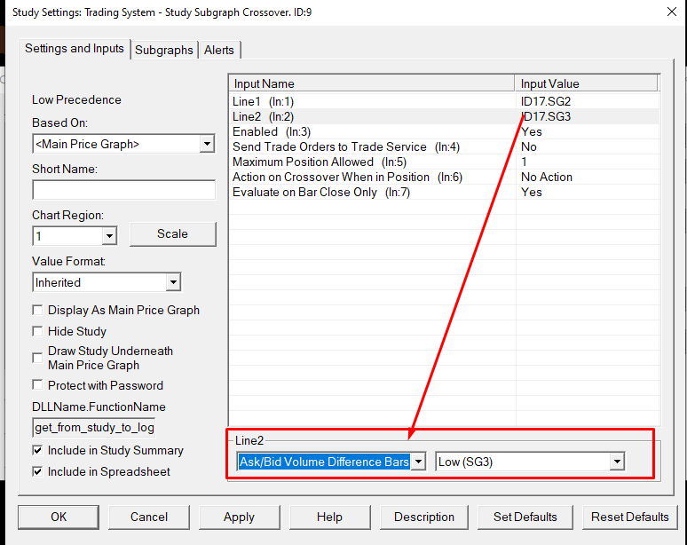

I cloned the SCSFExport scsf_TradingSystemStudySubgraphCrossover(SCStudyInterfaceRef sc)
and added a log function of the 2 subgraphs (SG2 and SG3) of the above study
when logging SG2 - it's getting the correct data but regarding SG3 or SG4 - I am not getting any values
I am attaching my test cpp as screenshots of my setup as well as a sample of the log (where Max = SG2 and you can see there is no value for SG3 at 2nd and 4th line)
Chart: ESH21_FUT_CME[M] 1000 Volume #6 | Study: Trading System - Study Subgraph Crossover | Max = 219.000000 | 2021-02-23 15:54:42.932
Chart: ESH21_FUT_CME[M] 1000 Volume #6 | Study: Trading System - Study Subgraph Crossover | | 2021-02-23 15:54:42.932
Chart: ESH21_FUT_CME[M] 1000 Volume #6 | Study: Trading System - Study Subgraph Crossover | Max = 62.000000 | 2021-02-23 15:55:00.434
Chart: ESH21_FUT_CME[M] 1000 Volume #6 | Study: Trading System - Study Subgraph Crossover | | 2021-02-23 15:55:00.434
please advice

[2021-02-24 06:44:41]
Flipper_2 - Posts: 57
Thats because you have an error in your code. : )
float Min = StudyLine2[sc.Index];
SCString MessageText2;
MessageText1.Format("Min = %f", Min); <<<<<<<<<<<<< wrong SCString !
sc.AddMessageToLog(MessageText2, 0);
You are formatting MessageText1 both times
