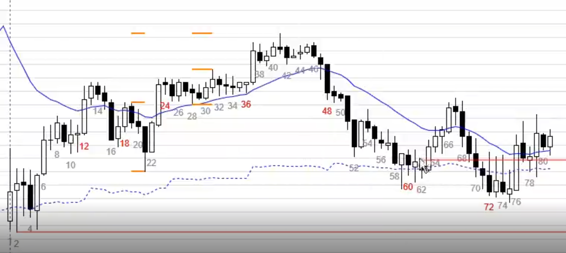

To Sierra Chart Engineering: I don't have any programming skills so if you can add the necessaries lines to the original code I would be appreciated.
To tomgiilb: I have just tried out your method and it worked :) But the result is identical to the "Bar Numbering" study. I want the result as the attached image, only specific numbers in colour while the rest remains the same.

Sawtooth - Posts: 4361
UnHide the Bar Numbering study and the others will be there.
Just be sure the Color Bar study is below the Bar Numbering study in the Studies to Graph list so that the Color Bar study overpaints its color.
