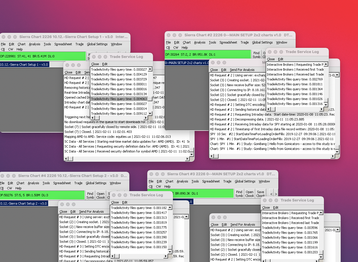

I upload a picture of my 4 main. you can see the Data they use. Its all ticker that I already have in my main data folder ( but its on another location not the sierra chart folder ) But still , when the instance are create , they copy all the require files to have my chartbook, trading preference and Study preset setup.

I just post another picture showing that my data folder on subfolder is getting bigger too. ( that is why I ask if I should copy my main folder to the Subinstance. )
and I just wonder If the data from the subinstance is getting it directly from the Main data or it download it from the server ? That will help me understand if I need to update all ticker on all subfolder with the Global settings - intraday file update.
