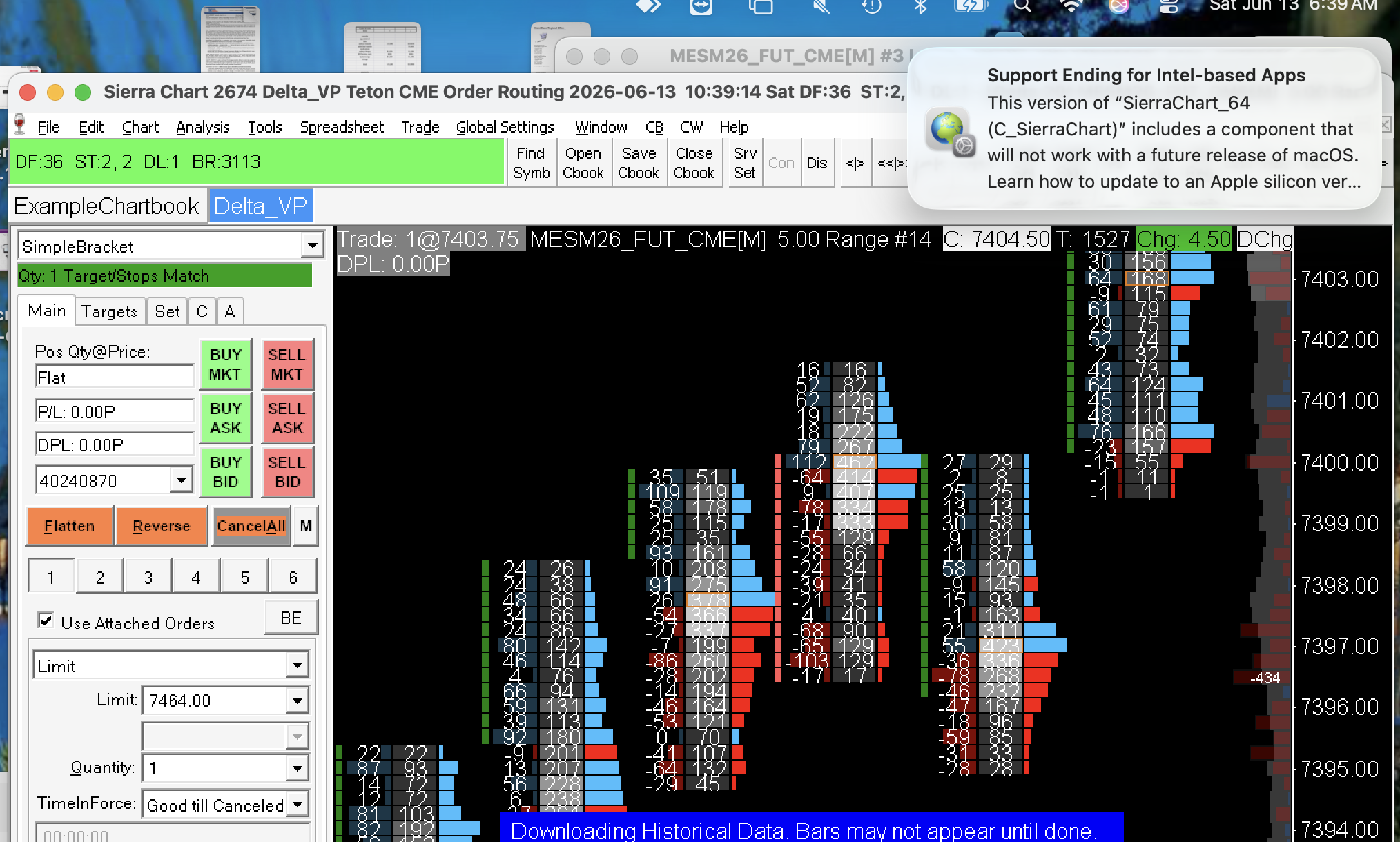

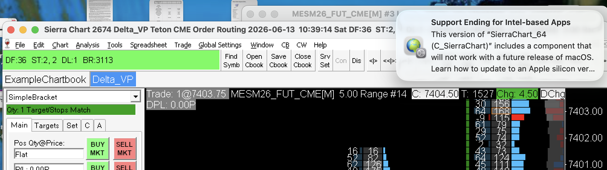

| User705490 - Posts: 17 |
@user584084 @bdunn have you or anyone in this chain seen the attached notification on your Mac about "SierraChart_64 (C-SierraChart) has a component that will not work with a future release of macOS" and update to Apple Silicon version? If so, what SC version are you using with Crossover and where did you find the correct SC version to use? Thank you for the support. |

| [2026-06-24 19:42:02] |
| User584084 - Posts: 345 |
This thread was started as a Crossover thread. There is information about Parallels in this thread also. Crossover 24.x.x and later require MacOS 10.15.x or later to work. Video cards in older Macs may not compatible with newer versions of Crossover beginning with Crossover 24.x.x and later. Codeweavers has a 14 day free trial of Crossover that you can try SierraChart with. Go to codeweavers dot com and download it and try it. Date Time Of Last Edit: 2026-06-24 21:19:56
