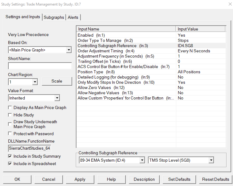

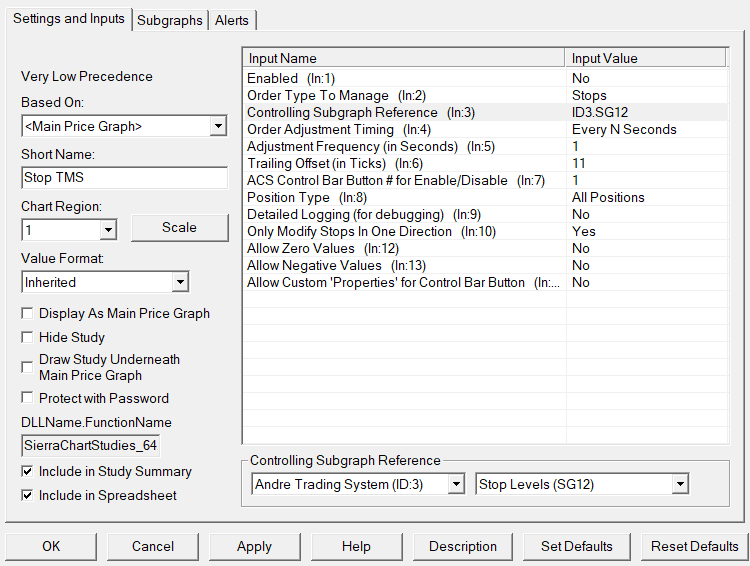

I'd like to use the fix targets from the trade window, and the stop from TMS which refernces a column on my spread sheet (column V)
My trade window config is attached as well as a screenshot of the TMS settings.

I set up a new .twconfig to test the stops but it does not set the stop where I want it. So the Stop problem is back... above I had an issue with the targets which I did not yet test and only want to do that when the stops are working propperly.

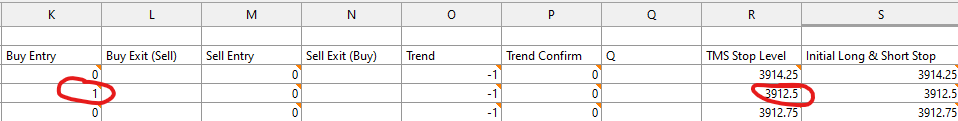

The stop should be $J$9-2 for the initial stop which comes from R3 in the spreadsheet with the following formula: =MROUND(IF($J$8>0,$J$9-2,IF($J$8<0,$J$9+2,0)),0.25). It is set to update every second in TMS.
It appears that R3 gets overridden by the offset set to 0 in the TMS study.
I attached all relevant screenshots.
Thank you for any guidance in advance.

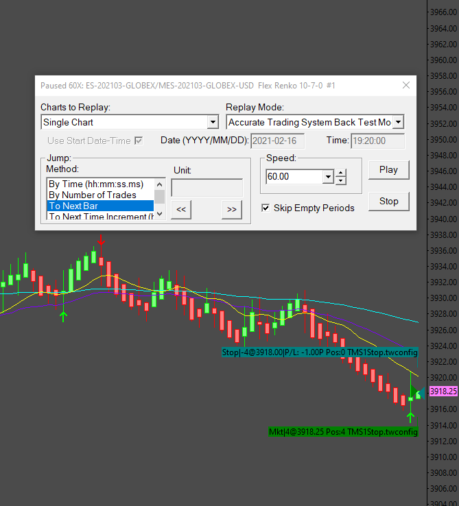

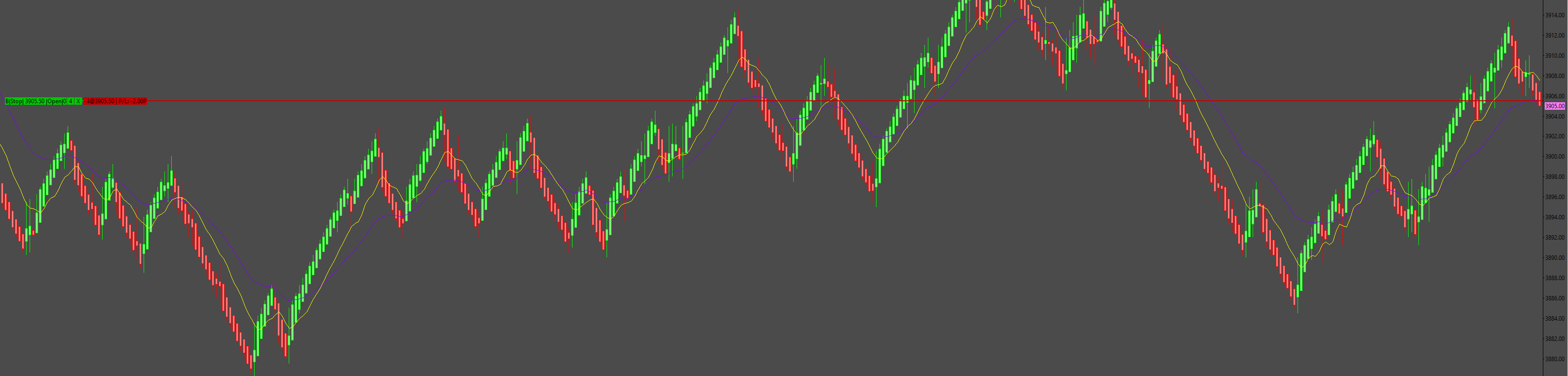

I did some replaying and i can't figure out what is preventing TMS not to take action. I changed the above Stop trigger as I thought the problem might be that the stop only gets triggerd if $J$8<>0. However, this does not solve the problem as you can see in the attched screenshots.
As said above, cell R3 is intended to feed the stop levels to TMS. Attached, you will see the levels in R3 vs what is happening in the replay.
Again, any help is SUPER appreciated as I am completly stuck and read all threads and documentation.

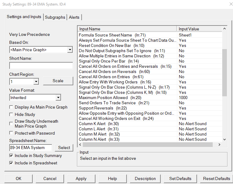

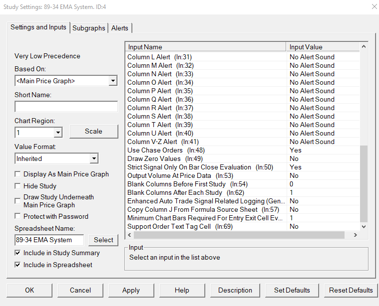

And here are the TMS and Spreadsheet study inputs if this helps
Date Time Of Last Edit: 2021-02-17 12:20:11
imageSpreadsheet Study Inputs1.png / V - Attached On 2021-02-17 12:18:18 UTC - Size: 87.51 KB - 276 views
imageSpreadsheet Study Inputs2.png / V - Attached On 2021-02-17 12:18:23 UTC - Size: 83.37 KB - 344 views

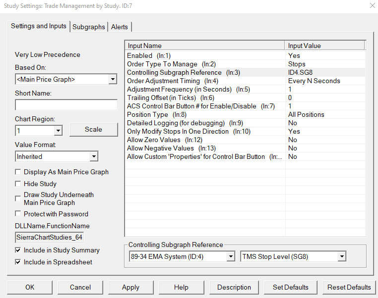

TMS inputs
imageTMS inputs.png / V - Attached On 2021-02-17 12:23:23 UTC - Size: 68.2 KB - 366 views
[2021-02-17 22:31:46]
We do not see anything that should cause any issues. The one thing we want to point out though, is that you have the TMS Input for Only Modify Stops in One Direction to Yes. Is this perhaps why you are not seeing what you expect, that the Stop is only going to adjust up and not both up and down?
