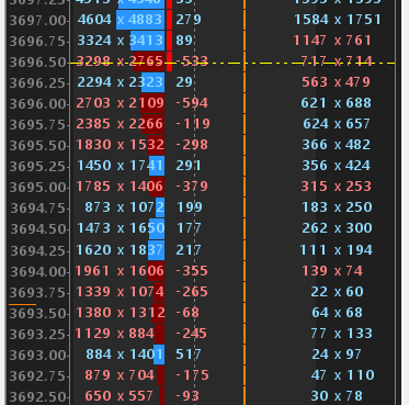

I can't figure out why this is, but I cannot get a subgraph label from a spreadsheet, to appear on the value scales (left or right). It displays fine everywhere else (left, right, left/right edge) but interferes with my numbers bar. I don't want to have to enable the label column as it takes up to much horizontal real estate.

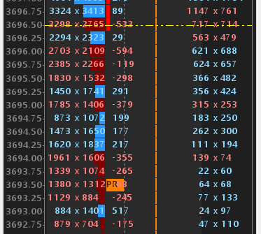

Attached are two images of what's happening. One is the label on the values scale, you can just see a faint orange line where the label is - it's showing just a couple pixels of it. The other is with the label set to "left" align, and it works just fine.
Any ideas on what's going on here?
imagelabel_in_left_scale.png / V - Attached On 2021-01-29 22:19:00 UTC - Size: 38.21 KB - 334 views
imageLabel_on_left.png / V - Attached On 2021-01-29 22:19:05 UTC - Size: 34.76 KB - 423 views

I had to solve this one on my own and finally did. The issue arises when the left side scale is enabled and the scale increment is set at 0.25 (ES). This causes so many numbers in the scale that there is not room for the label to be drawn. Letting it switch to Auto, creates more room between price levels and the label now appears.

Although just to clarify, my labels still disappear and go "under" the price levels when they cross with one. There seems to be no way to keep the labels "on top" of the price scale.
