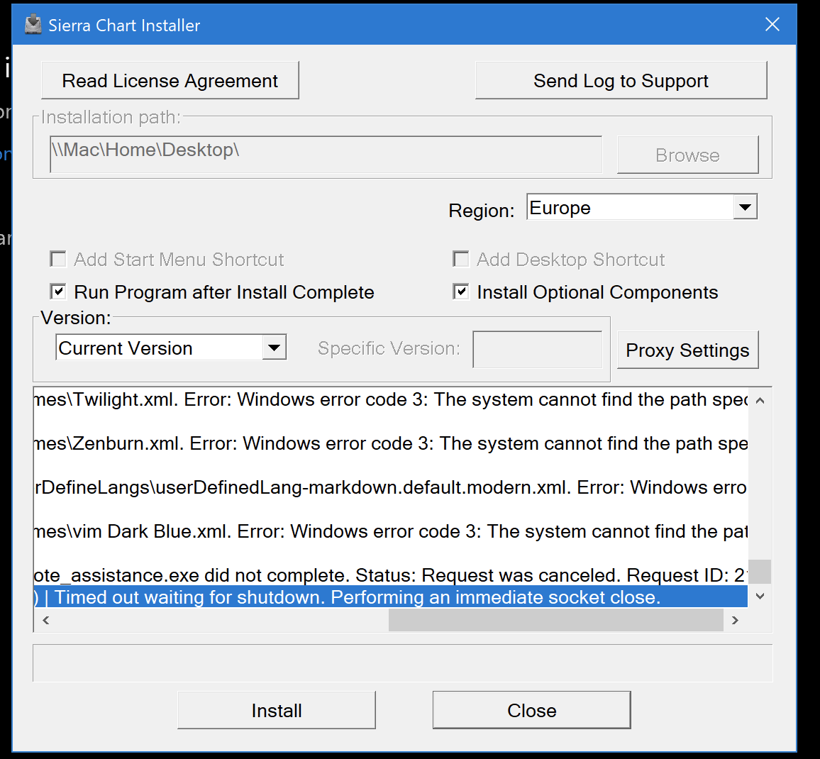

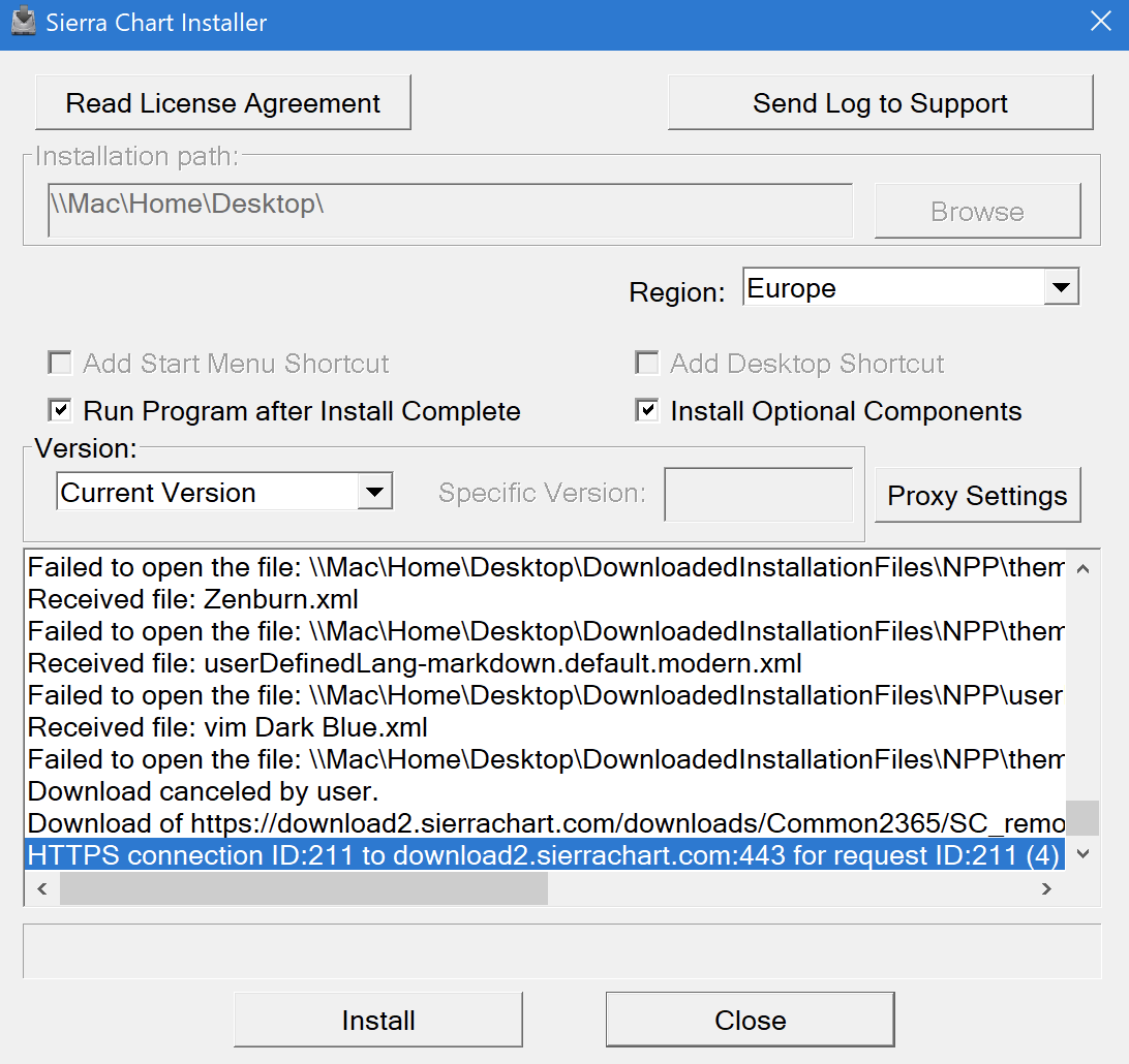

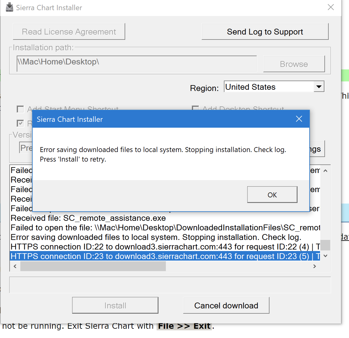

[2022-11-20 22:35:24]
EddieRokit - Posts: 13
Hi there
I am the same problem and have ran through the troubleshooting, turning off all antivirus/anti-malware software, re-downloaded the updated version but my files are still failing to download. I have attached a screenshot of the error messages
Thank you
imageScreenshot 2022-11-20 at 21.39.46.png / V - Attached On 2022-11-20 22:33:03 UTC - Size: 138.68 KB - 328 views
imageScreenshot 2022-11-20 at 22.32.03.png / V - Attached On 2022-11-20 22:33:11 UTC - Size: 127.88 KB - 311 views
imageScreenshot 2022-11-20 at 22.32.38.png / V - Attached On 2022-11-20 22:33:18 UTC - Size: 119.17 KB - 224 views
[2022-11-21 14:56:50]
There is some issue with the particular installation path you have selected. It is not being recognized by the operating system. Or there is some problem with the installer processing it. It is hard to tell because we do not have the complete log in a text format.
Try using the zip installer:
Software Download: Sierra Chart Zip Installer
Date Time Of Last Edit: 2022-11-21 15:00:22
