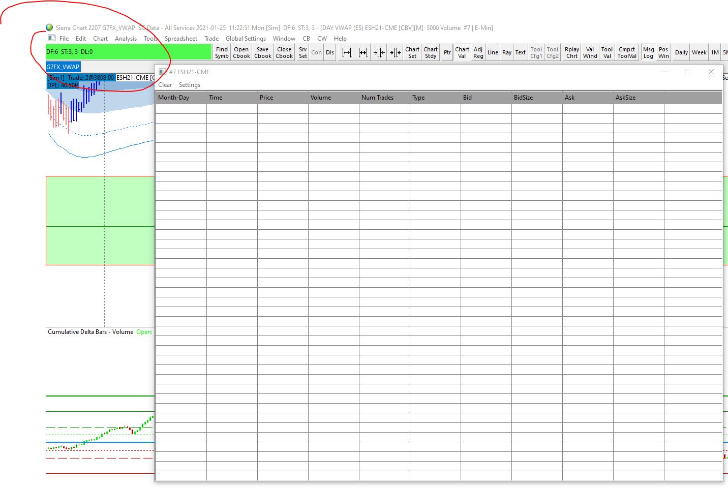

I was just sim trading normally on the delayed Denali feed, and about 10 minutes ago everything stopped, I'm not receiving any new tick (last one is from 11:03 ET), Time and sales is now empty after restarting and DF status is green, although I'm not sure if the various numbers indicate any problem (see picture).
Thank you

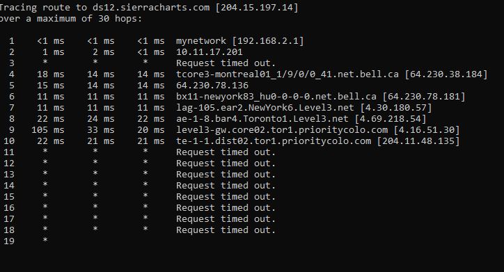

EDIT: Adding Traceroute of one of the Sierra servers, does this give any indication as to what is failing in the connection?
Date Time Of Last Edit: 2021-01-25 19:21:43
imagetraceroute.JPG / V - Attached On 2021-01-25 19:19:06 UTC - Size: 57.06 KB - 353 views

The trace route is not helpful to us. This is the relevant error:
DTC Client socket (2) | Connect event error. Windows error code 10060: A connection attempt failed because the connected party did not properly respond after a period of time, or established connection failed because connected host has failed to respond. | 2021-01-25 11:45:47.574 *
If you are still having problem, you have some connectivity issue to the server.

The traceroute shows that the connection gets past the ISP and that it's very probable that your server is refusing to respond to my client. Is it not something you are willing to investigate for a paying customer?

This definitively is not the issue. And there are three different delayed data servers. You cannot even connect any of them. Something is blocking the connection on your side.
There is nothing for us to investigate. This is fully an issue on your side.

The traceroute invalidates that the issue is fully on my side, you should learn how to read it. And even if it was on my side, any decent customer service would look into it with me. Your attitude is very unprofessional and unhelpful I'm starting to understand why you sell your software so cheap. I will definitely not be renewing my subscription.
