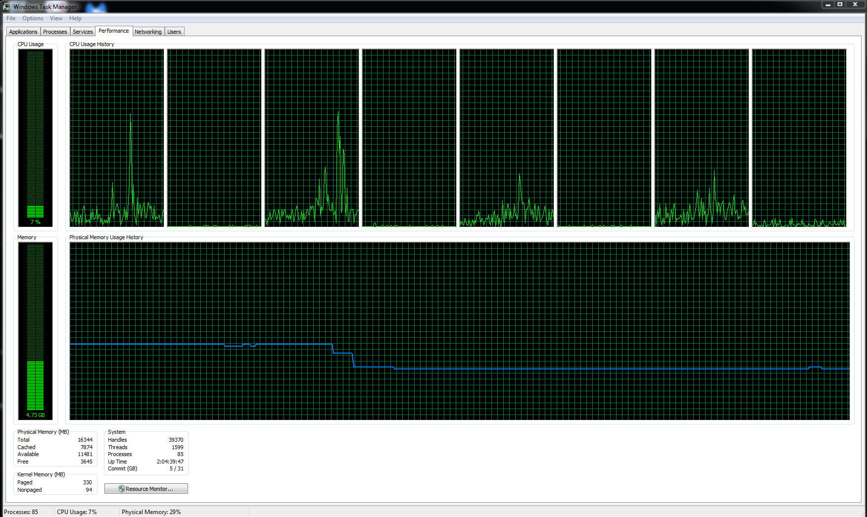

[2014-05-01 20:55:29]
Userpat617 - Posts: 2
MAKE SURE YOUR RAM UP TO SPEED CAS 10 1833MHZ OR MORE 24MHZ WITH CAS 10 OR 11
imageNM.PNG / V - Attached On 2014-05-01 20:47:35 UTC - Size: 109.02 KB - 896 views
