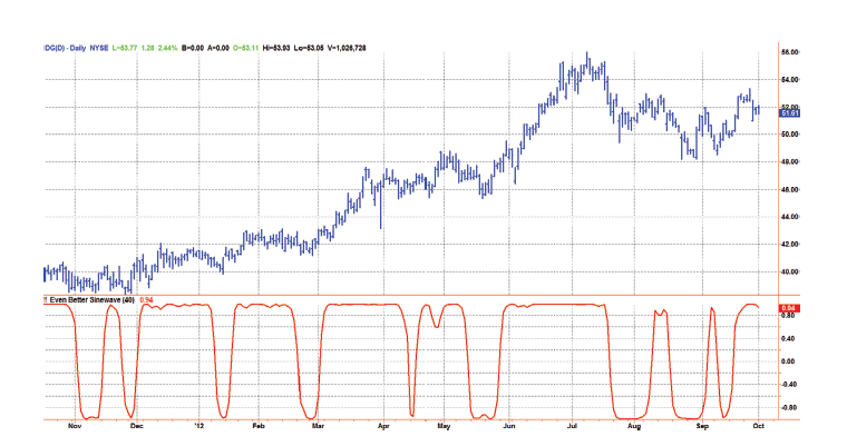

Is it possible to get a native version of John Ehlers' Even Better Sine Wave in Sierrachart?
This study is from the 2013 book "Cycle Analytics for Traders" and is a great timing tool. Especially for intraday Futures data.
Here is the Easylanguage code from the book:
Even Better Sinewave Indicator © 2013 John F. Ehlers

Image of plot attached.
imageebs.png / V - Attached On 2021-01-21 14:27:48 UTC - Size: 130.42 KB - 717 views

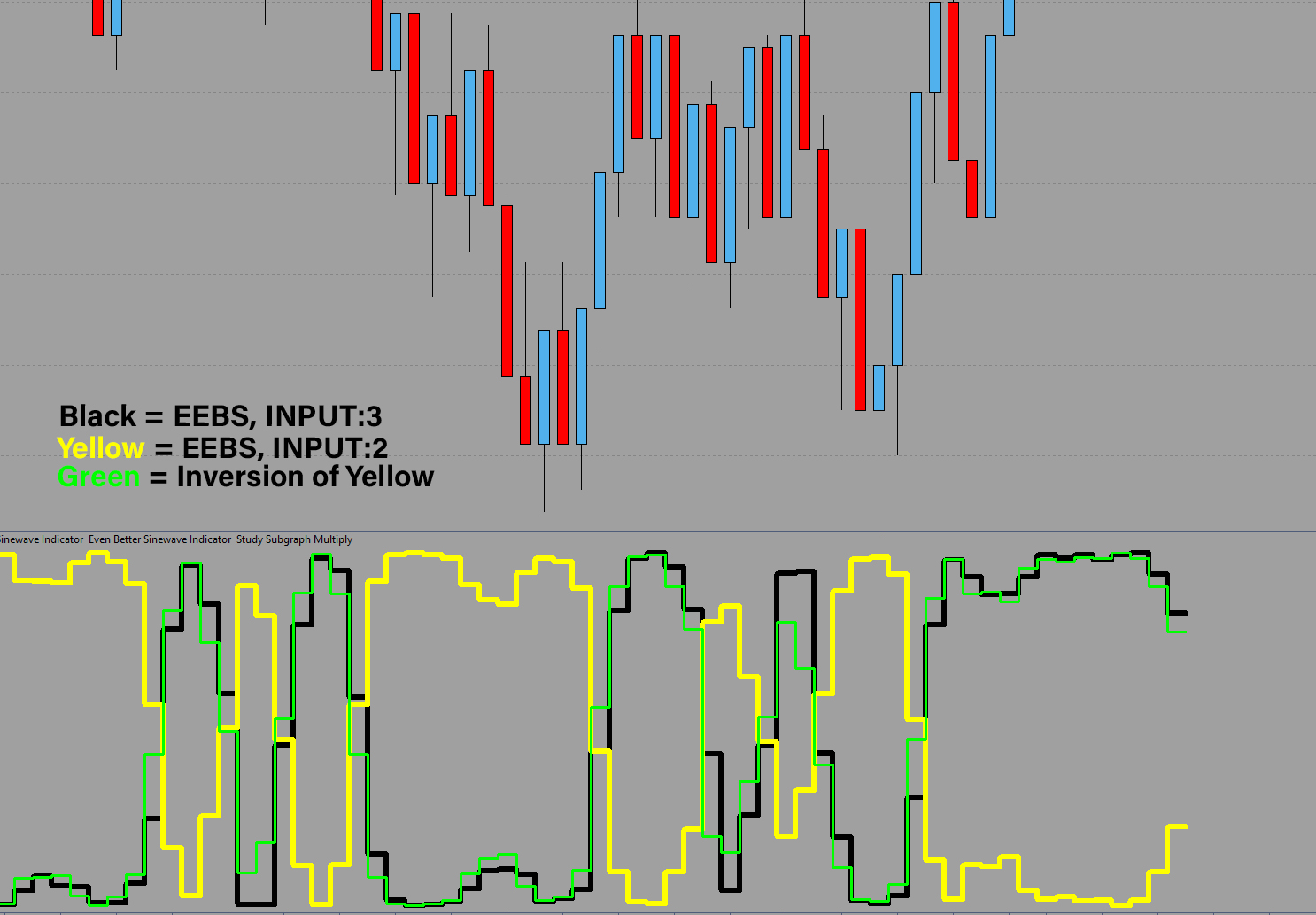

cmet - Posts: 747
I don't see an image attached even when I log in. Just says Private File.
I'm sure what you're saying is right but please take a look at the attached image.
You can see that an input of 2 in the study interface, when inverted, plots like the 3 input but is a bit more responsive (faster).
That's exactly what you would expect.
All I'm asking is you don't put the limit on it so I can continue to use the study this way.
imageEBS.jpg / V - Attached On 2022-06-15 22:55:39 UTC - Size: 291.29 KB - 478 views

SC Support Tom - Posts: 450
WRT Post #11:
I just made it public. Please have a look at it.
It is more responsive, but with random data. This is a clear cut case of GIGO (Garbage In, Garbage Out).
No. A horizontal line at zero is exactly what you would expect.
Please observe:
alpha1 = (1 - sin(360/2))/cos(360/2) = (1 - sin(180))/cos(180) = (1 - 0)/(-1) = -1
HP = 0.5(-1 + 1)(Close - Close[1]) + (-1)HP[1]
HP = 0 - HP[1]
HP = -HP[1]
Since all Subgraphs are initialized to 0 by default, HP should be 0 for all values of sc.Index, and consequently, so should the values of the Indicator. But since the calculated values of HP differ slightly from zero, this is not what we see.
What you are looking at is due to the vagaries of floating point arithmetic in C++. That's it. It is not a problem for other values of the Length, because the errors are so small. But when the exact value of a calculation is 0, any error is a 100% error.
Strictly speaking, we should be disallowing a Length of 4 as well, since the exact value of alpha1 is undefined for that Length. But again, floating point error stops that from happening.
