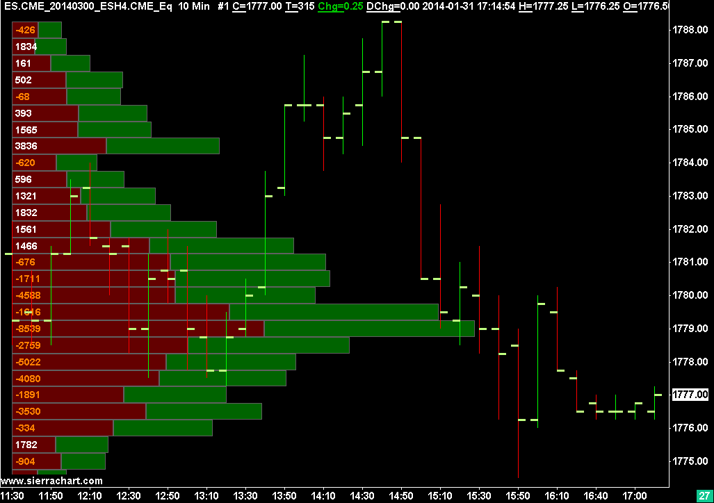

SC Support This is what you are looking for:
http://www.sierrachart.com/image.php?l=1391378255667.png It is now done and will be released tomorrow. v1094 nonCLR VbP --> Volume Numbers Text Color and Size -> AutoColoring: Based on +/- It does not work

You need to use the primary and secondary Color buttons. Not the Auto coloring setting. This is from the documentation: Volume Numbers Text Color and Size (SG15) This Subgraph controls the Color and Font Size of the volume numbers text displayed on the Volume Profile bars, if you have set the Display Volume in Bars Input setting to display the volume numbers to a setting other than None. The Primary color setting controls the text color when the volume text is positive. The Secondary color setting controls the color when the volume text is negative. The Size setting sets the Font Size. If it is set to 0, then the font size is automatic. All other Subgraphs settings are not used for this particular subgraph. Sierra Chart Support - Engineering Level Your definitive source for support. Other responses are from users. Try to keep your questions brief and to the point. Be aware of support policy: https://www.sierrachart.com/index.php?l=PostingInformation.php#GeneralInformation For the most reliable, advanced, and zero cost futures order routing, *change* to the Teton service: Sierra Chart Teton Futures Order Routing |

SC Support I've checked it again It does not work in case UseTransparentDrawStyle is Yes. |
| [2014-02-20 00:39:01] |
OK for now do not use transparency and we will look into the problem.
