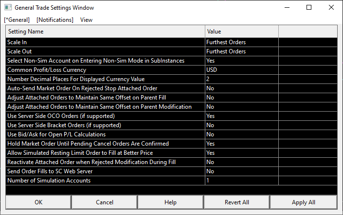

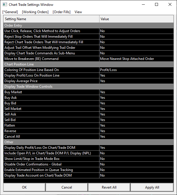

[2020-12-30 18:52:07]
AC136339 - Posts: 34
Unfortunately I have to ask one last question.
Why do I have the general trade setting and chart trade setting menu like this as attached?
thanks a lot
imageSi.png / V - Attached On 2020-12-30 18:50:54 UTC - Size: 31.94 KB - 309 views
imagesi1.png / V - Attached On 2020-12-30 18:50:59 UTC - Size: 41.37 KB - 368 views
[2020-12-30 21:34:18]
John - SC Support - Posts: 48419
We are in the process of changing our dialogs. Those are the new format. It is a process that will take some time and will roll out slowly. The Settings dialogs are some of the first we are working on.
