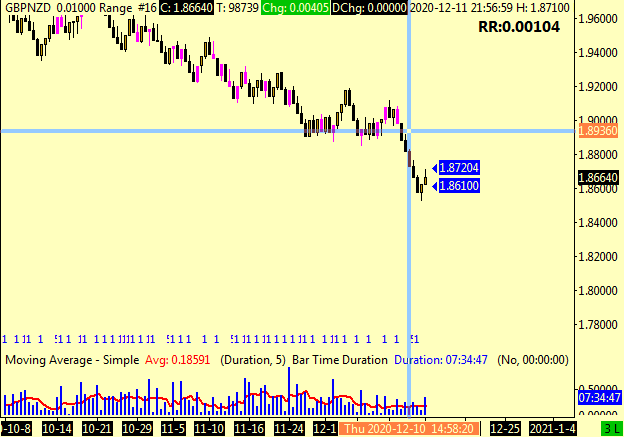

[2020-12-13 00:25:36]
cfuture - Posts: 86
I can recall having the same problem with recentering after price has deviated so many ticks from the center, but it was some time ago and as far as I can determine now, it is working ok since I have tried it out recently. I use version 2196.
I just discovered the setting "constant range scale recenter on interactive scaling change" in the scaling settings to automatically recenter after any changes to the chart. After removing the tick, there is no recentering after making any changes to any chart.
Regarding the recentering of price during the opening of the chartbook: my focus is to open up 15 chartbooks with 16 charts without having to adjust anything to see the entire scope of price action as it was when I closed the chartbooks. The position of price on the charts when I closed should be the same as when I open them again. What happens though when opening, the charts are automatically recentered. Maybe there is a setting I have to discover. I have attached an example of a chart after opening- http://www.sierrachart.com/image.php?Image=1607813214575.png
[2020-12-14 14:28:07]
John - SC Support - Posts: 48420
When you open the chart, it is going to download any missing data and then display the most recent bar in the chart. That bar is then centered according to the scaling rules that you have setup for the chart.

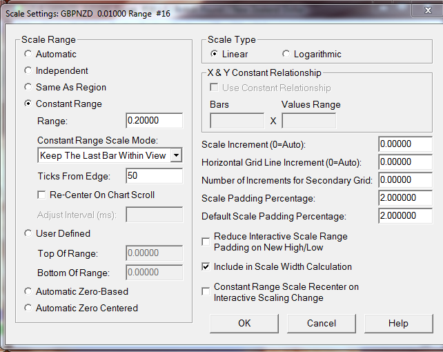

[2020-12-15 14:51:29]
cfuture - Posts: 86
see attachment
imagescale settings gbp-nzd br100.PNG / V - Attached On 2020-12-15 14:48:53 UTC - Size: 86.51 KB - 451 views
[2020-12-15 15:33:45]
Therefore it is going to make sure that the last bar is in view when it loads the charts and updates the missing data.
Is there some other behavior that you want to occur?
