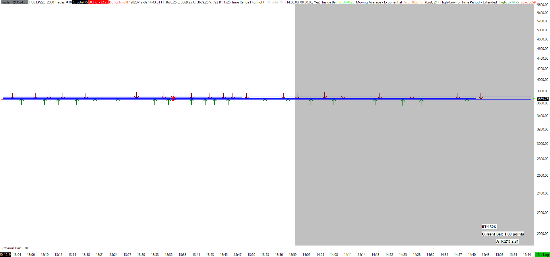

Whenever I choose range scale: automatic, the chart looks like the one in the link below. What would be the correct setups so that my chart displays correctly? I've tried different things, and nothing works. Other range modes like range scale: constant mode, work fine

First thing to do is to Reset the scales to make sure that this is not just due to accidental manipulations. Refer to the information here:
Chart Scale and Scale Adjusting: Resetting the Scale
If, after resetting, it continues to show like in the image, then that means that you have a study that has the larger range than the underlying data that is causing the scales to expand to fit it in. Refer to the information here for how to handle this:
Chart Scale and Scale Adjusting: Basing Scale Only on Price Bars

Got it... thanks! Adjusting one of my study's range fixed it
