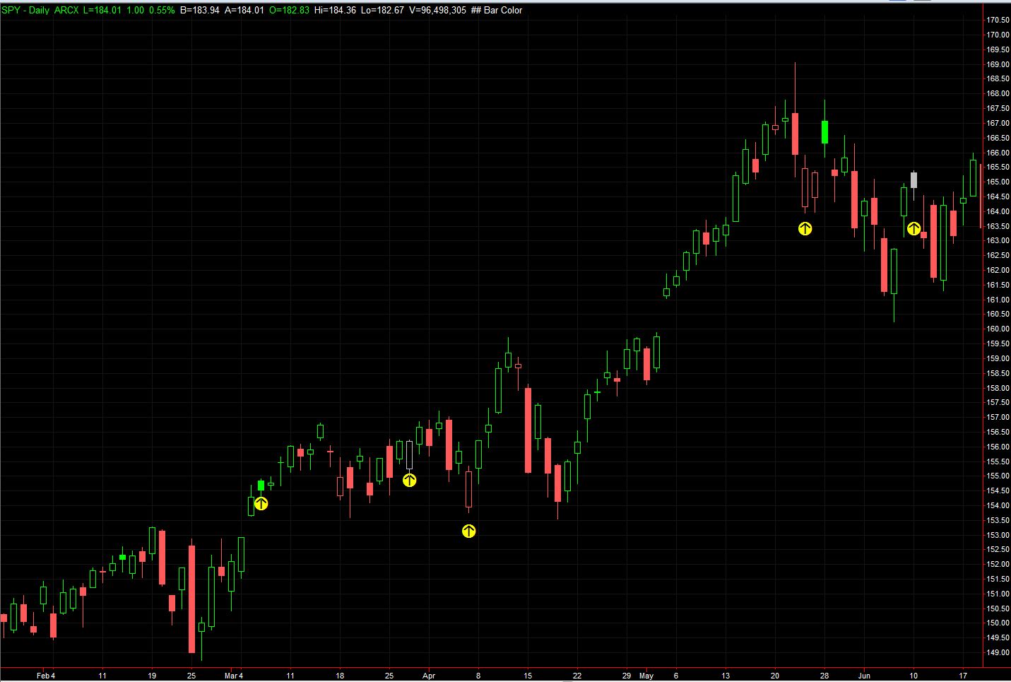

drywater0 - Posts: 85
SC Support,
Is it possible to implement coloring for the Candlestick graph draw type which takes into account both the Open and Previous Close? What I'm trying to accomplish is best illustrated by example:
(1) Candlestick outline color is determined by comparing Close vs. PrevClose: green for up, red for down, and grey for unchanged.
(2) If Close > Open then body is transparent with no fill color.
(3) If Close < Open then body is filled using the color scheme set in (1).
The result is that the typical Up bar will be a hollow green candlestick and the typical Down bar will be have a red fill for the body. The atypical scenarios are:
(a) Close > PrevClose but Close < Open produce a green bar with the body filled green.
(b) Close < PrevClose but Close > Open produce a red bar with a transparent body.
(c) Close = PrevClose produces a grey bar with transparent body if Close > Open and a grey filled body if Close < Open.
I attach a screenshot for further illustration with the exceptional / atypical days highlighted with a yellow arrow. Many thanks in advance for your help.
imageCandlestick Coloring Example.JPG / V - Attached On 2014-02-15 23:35:33 UTC - Size: 169.32 KB - 812 views

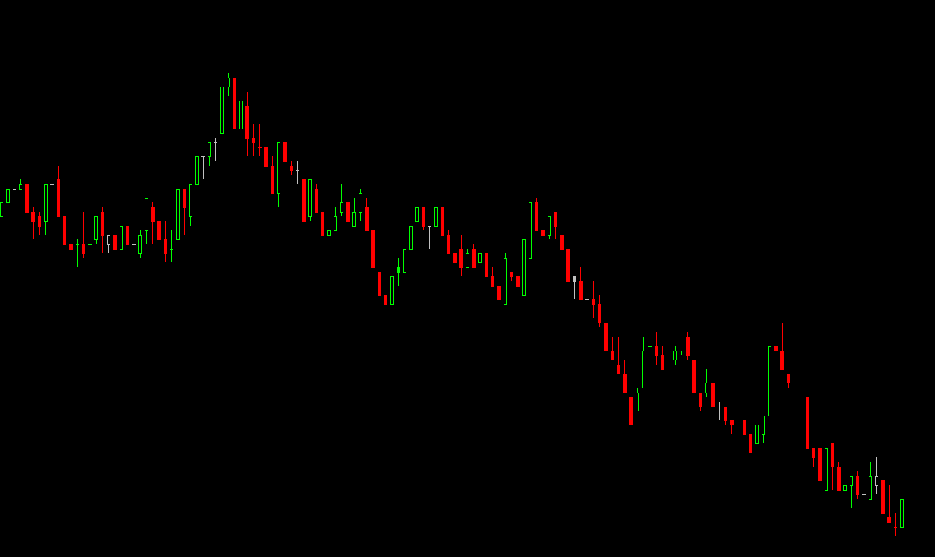

[2020-04-23 21:09:54]
Ackin - Posts: 1865
Hi, You can download
Study: Candlestick Enhanced Coloring
from the library Free1 (2020)
contact link:
imageCandlestick Enhanced Coloring.png / V - Attached On 2020-04-23 21:09:51 UTC - Size: 22.46 KB - 589 views
