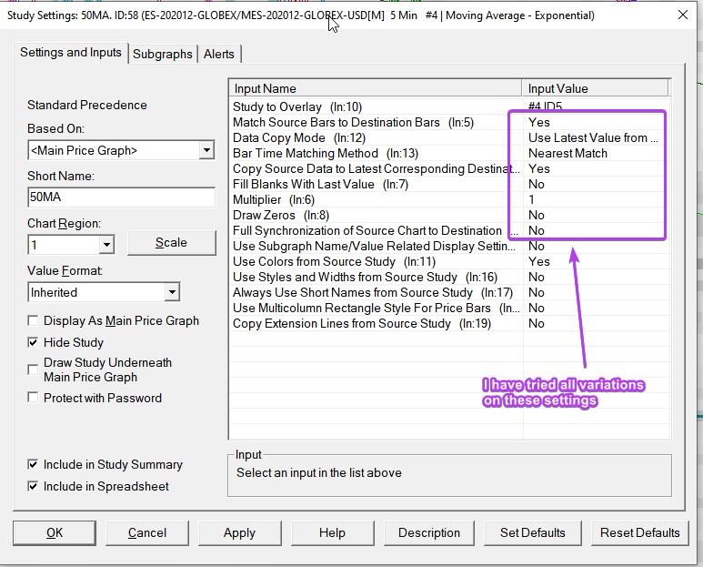

To better clarify the study with the issues, it is the Study/Price Overlay from a 5 min chart onto a low price change chart.
I have experimented with all the settings in the attached image to no avail.
This worked absolutely fine in 2192 and lower.
image201130_0845_57.png / V - Attached On 2020-11-30 00:48:04 UTC - Size: 55.8 KB - 335 views

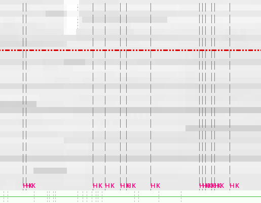

Acro - Posts: 459
And here is how a single timeline study is repeated multiple times.
This one is for HK Open at 0900 China time
image201130_0902_53.png / V - Attached On 2020-11-30 01:04:29 UTC - Size: 21.47 KB - 402 views
