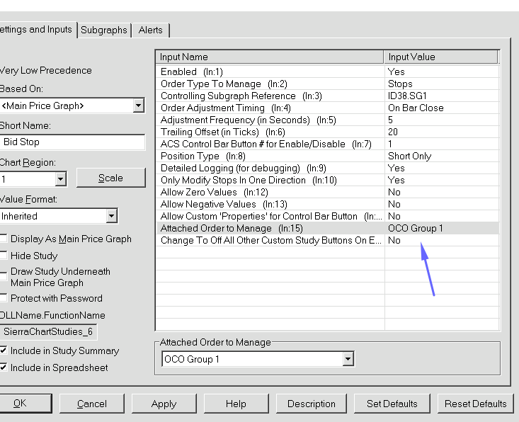

[2023-07-03 16:03:29]
Hopeman - Posts: 166
Does the OCO configuration have to be in the TMBS?
imageOCO?.png / V - Attached On 2023-07-03 16:03:15 UTC - Size: 35.26 KB - 408 views
[2023-07-03 16:08:05]
ForgivingComputers.com - Posts: 1253
It doesn't hurt, but you can leave it on Nearest if you are only doing one trade at a time.
