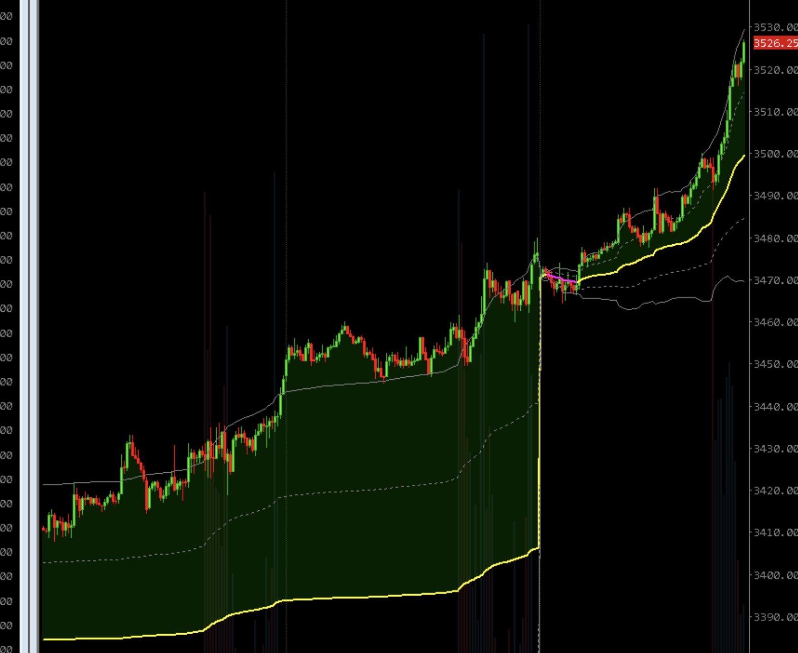

Sup Boys,
I know how to color between the vwap bands but is it possible to transparent fill above or below the vwap towards the price not the stdev lines?
File attached. Would be awesome to color it according to the slope as well.
Thanks in advance!
imageScreenshot 2020-11-19 at 09.45.55.png / V - Attached On 2020-11-19 08:48:31 UTC - Size: 297.68 KB - 419 views

You can fill in between the VWAP and the price by using a Study Subgraphs Reference study and using the Last from the Main Price Graph for one of the studies and the VWAP for the other.

maskenJL - Posts: 20
Thank you for the tip, but I just can't get it to work for some reason.

John - SC Support - Posts: 48490
What is the exact problem you are having?
A couple of tips:
- The Study Subgraph Reference defaults to displaying in a different region, so make sure you change the region to Region 1 (or wherever you have your Main Price Graph).
- The Study Subgraph Reference defaults to an Independent scaling. Make sure you change the scale to "Automatic".
