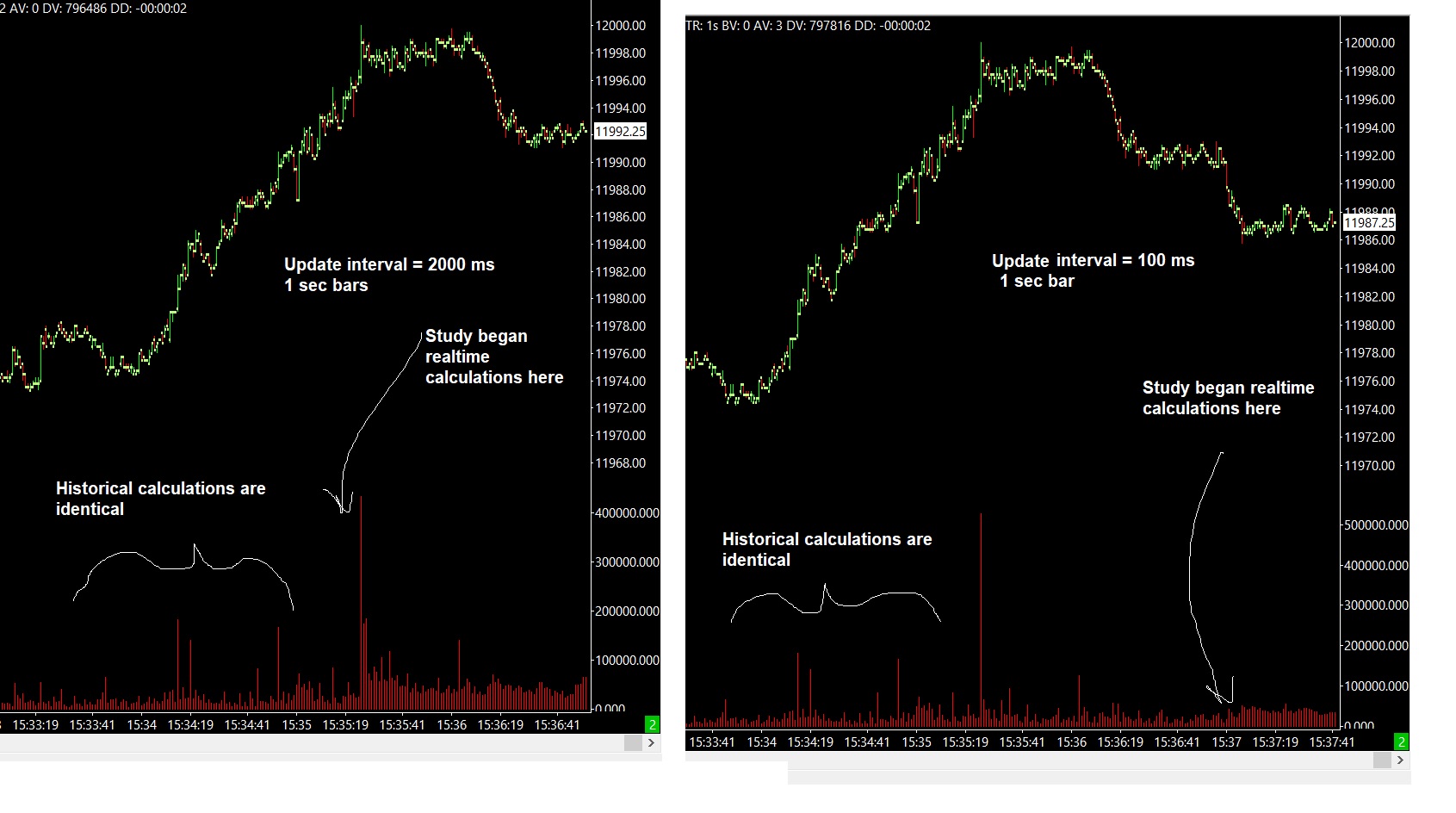

I actually am finding this to not be true in one case...
I have a study which is based off your study that sums charts. It sums the volume of whatever charts are open, more than 10 charts
The historical calculation is identical- it does not depend on what the chart update interval is.
However, once the real time calculations begin, I get different results depending on chart update interval.
I am sure to clear the subgraph data to zero before each loop through the charts (to gather the volume data up). This still does not give a consistency.
See attached.
imageupdateinterval.jpg / V - Attached On 2020-11-19 20:45:37 UTC - Size: 270.96 KB - 339 views
[2020-11-19 23:20:42]
jomo88 - Posts: 47
I think I found the solution... GetBarHasClosedStatus
